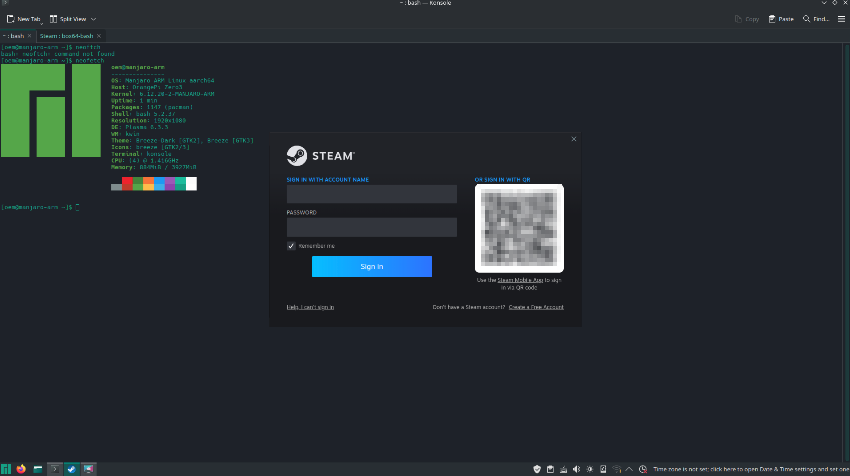

I’ve builded steam and box64 with box32 support
https://drive.google.com/drive/folders/1hAr_PB52fIBcZOgtx2WoGghv63H1-JzB?usp=drive_link
It won’t start on my device, maybe it’s due to the 1GB ram (steamwebhelper crash). If someone has a chance, try it on another device
I remember reading about pkgbuild on arch but I don’t think it will still be there as they removed it all for arm64 pkgs.
The problem was a small amount of RAM. On zero3 with 4GB steam started up
