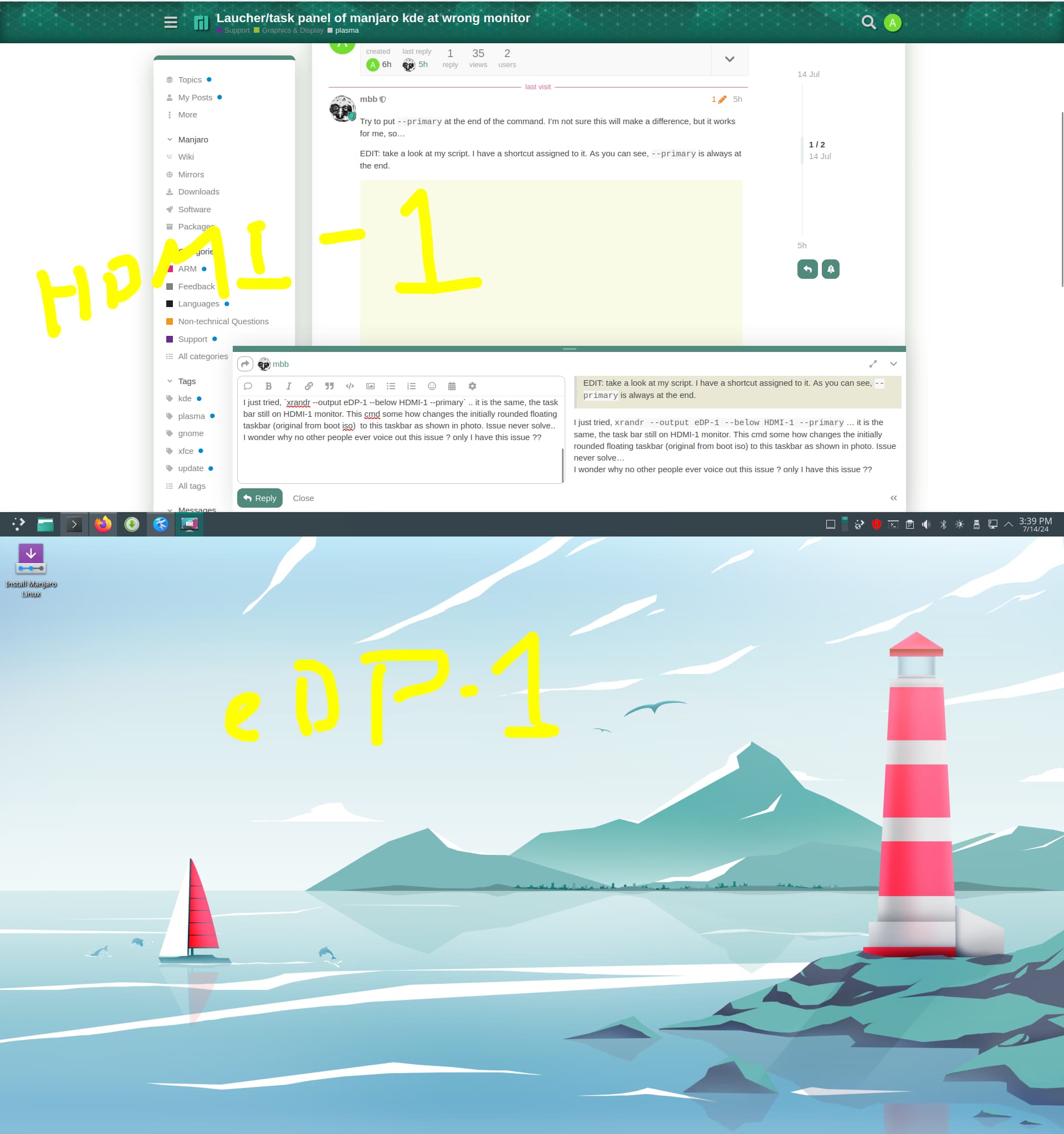

Laucher/task panel of manjaro kde at wrong monitor
I am still booting up from manjaro latest kde image file.
it is in x11.
$ xrandr --listactivemonitors
Monitors: 2
 0: +*eDP-1 1920/344x1080/194+0+1080  eDP-1
 1: +HDMI-1 1920/160x1080/90+0+0  HDMI-1
HDMI is ontop of EDP monitor. task bar should be on eDP-1, however it keeps place on HDMI-1…
xrandr --output eDP-1 --primary --below HDMI-1
run this command above, but the task bar still on HDMI monitor…
Any idea how to in commandline make taskbar on eDP-1 monitor ?

I just tried, xrandr --output eDP-1 --below HDMI-1 --primary … it is the same, the task bar still on HDMI-1 monitor. This cmd some how changes the initially rounded floating taskbar (original from boot iso) to this taskbar as shown in photo. Issue never solve…
I wonder why no other people ever voice out this issue ? only I have this issue ??
you should know better by now.
please do not poste screenshots - they are useless
what do you meant screenshots are useless ? it proves what i claimed it is … means i am not lying or mislead people around.
I posted the screenshot to show the location of the taskbar…

yes, I know how to do that with GUI. but i wash to do it in cmdline. because i will be stuck with boot image for a while, while learning how to fix the broken os. Since live image does not support “suspend into ram” i will have to shut it down each night… then the next day when i power on, i will need to adjust it again. Also, when i bring laptop to other person house, when plug into her hdmi tv, the task bar will jump to the tv again… i will have to set it up by messing around in gui…
I see what you mean; I’d forgotten that bit. Sorry, not sure why this is the issue, or an “easy” workaround for working off Live .ISOs, but what happens if you set the other monitor as “primary”? Counter-intuitive, I know. :man_shrugging: But I see your browser is on the top display, guess you moved it there.
Cheers :slight_smile:
You can first turn off the HDMI one to set the eDP as primary, and the reactivate it. But, honestly, I think it may be easier to do it through GUI. Plasma 6 made it really easy to do it. Right-click on the panel, enter edit mode and then select “Manage Screens and Panels” (or however it is written in english).
I agree with @mbb in this case; especially as it should hopefully only be a temporary workaround until the installed OS is fixed.
I think that the borked installation deserves more attention than this relatively minor inconvenience does, for now. :wink:
