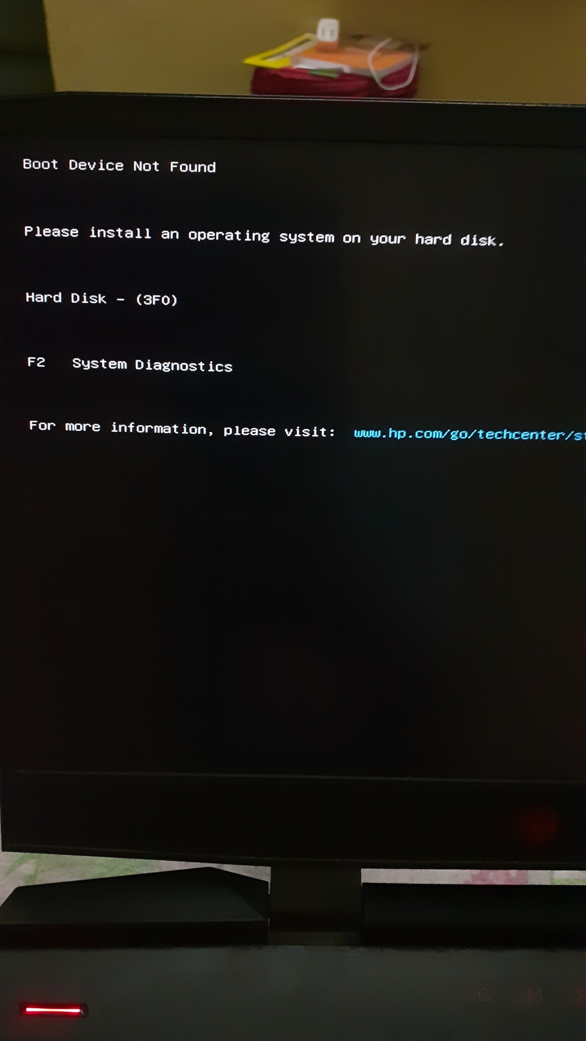

Ok, I closed my laptop lid( which puts it to sleep) and after some time, the laptop won’t wake up. The power button does glow, but that’s it. After holding the power button and forcibly shutting it down, I was greeted with this screen
I checked in the BIOS and basically it doesn’t recognize my SSD. It is an SSD+HDD laptop.
I’m stuck here, please help! Also I can’t post my inxi as I’m on my phone, please get it from any of my other posts! I’m sorry for the inconvenience but as you can tell, I’m very anxious wether I bricked my device or not.
I’m a complete noob.

This has happened before, I even tried using REISUB to shut down the laptop gracefully, but it gives the same ‘Boot device not found’ message, however this time, it lasted longer, usually, it goes away in 1-2 restarts and waiting for some time, but this time the wait was long and I freaked.

It seems, that has nothing to do with Manjaro.
https://www.ubackup.com/articles/hard-drive-not-found-3f0-error-8523.html
Thanks!
But doesn’t the ’ NOT WAKING UP FROM SLEEP’ has something to do with manjaro?
I checked the HP support for you :grinning:
Operating System: Microsoft Windows 10 (64-bit):
After a couple of attempts to restart the computer I can eventually access the OS, but the next session when I try to turn on my computer from sleep mode I get the error message again
Error 3F0, Boot Device Not Found - HP Support Community - 7751578.
Thanks for taking the pain! A couple of solutions have been listed, that I’ll try if the problem arises again. It hasn’t happened since I reverted to 5.10.
Edit: It happened again, and surprise surprise the steps given here didn’t work. Will continue to search for solutions.
