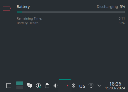

After resuming the system from hibernation, I attempted the unplug/plug-back-in trick again with the charger. This has worked for 2 seconds, until it switched back to the “Discharging” mode again.
I rebooted the laptop hoping it would reset whatever processes was supposed to monitor the “start charging again” threshold, however it had no effect. The charging indicator seems to be stuck on 5% “Discharging” state:
Could there be also an indicator issue?
Curiously enough, the battery has been holding on these levels for the entire time of me writing this post, so I’m guessing that charging is happening in some way. It’s either flipping on & off very quickly around this 5% threshold, or it’s charging, but the charging status or the battery level are both failing to give accurate readings. This is after a fresh reboot, so there’s not long-running state influencing it.

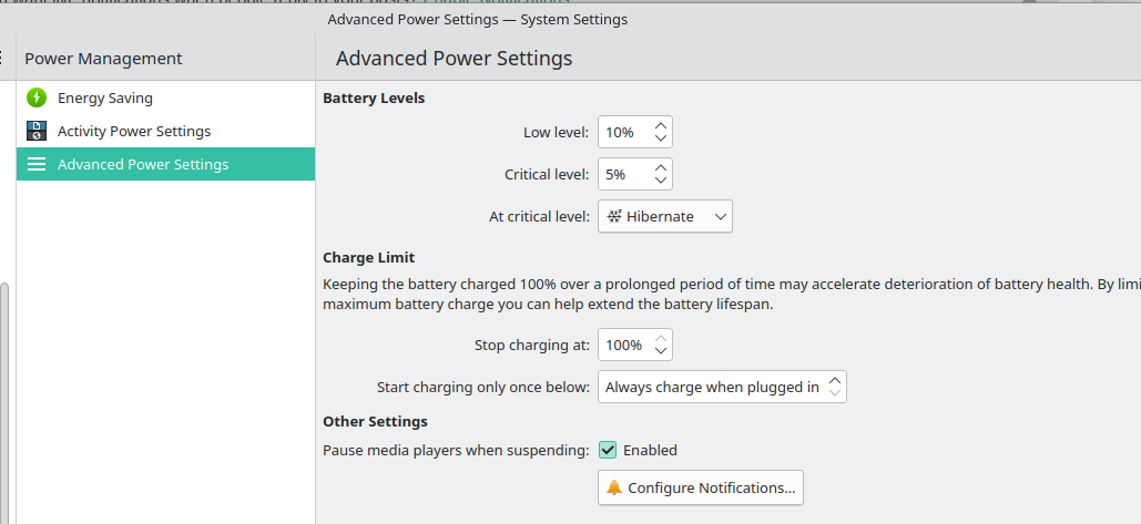

I don’t think it’s the settings:
I’ve checked the power settings, it appears that it’s set to be “Charging all the time when plugged-in”, which it is and was plugged in. So it shouldn’t be sitting on 5% period given the settings.
The only way I see the settings being an issue is if this “Advance Power Settings” page is lying:
and, perhaps, there’s supposed to be some new config elsewhere. I just don’t know.
