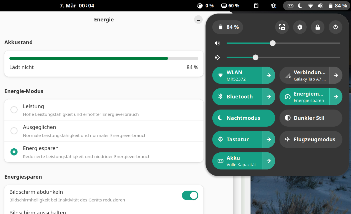

Meanwhile, after having judged several installable options (extensions) out there, I found a working solution that offers a fixed stop charge threshold at 80%. Well, that’s acceptable. It’s by the Battery Health Charging extension:
The extension is associated with the lowest green area in the screenshot. If this is set active (green), charging stops just before 80% is reached. The screenshot shows 84, but that’s due to experimenting with this mode on and off. It changes also the text associated with the bar of the energy settings window (“lädt nicht” - does not charge).
A few days ago I was a bit confused because of the text “Volle Kapazität” (full capacity) in this case, which was the reason for some experimenting. WelI, I have just updated this extension, and now the text is correct (max lifetime).
