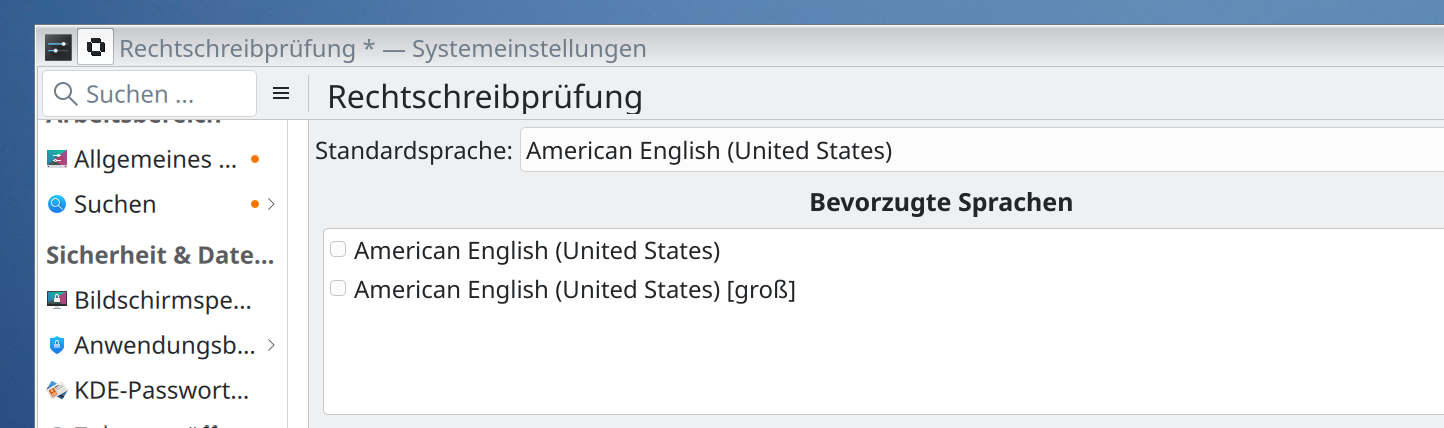

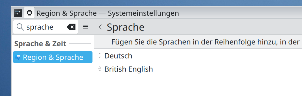

My language settings are set to German but changing the spelling settings does not work. What is the reason that within the settings menu, there is no option to select German. If the reason is that I need to install a different dictionary, why is there no option? How do I do this?

Also be aware that Plasma uses the file ~/.config/plasma-localerc which may overrule what is defined on the system level (/etc/locale.conf and /etc/locale.gen)
These are Plasma settings. However Plasma doesn’t really have a spell checker of its own. That is, the actual spell checking across K-apps like Kwrite or Kate or the spell ... in Krunner is performed by some 3rd party spell checker. There are different ones. I have hunspell installed. Then the spell checker program needs dictionaries like hunspell-de and so on for the languages you want to use. You can install these packages using the pamac gui and searching for hunspell. After installation you also need to restart Krunner from the terminal as your normal user (no sudo) like
systemctl --user restart plasma-krunner
There might be further hiccups depending on the language selection and the settings like Enable autodetection and Automatic spell checking enabled by default. Non-K apps may come with their own spell checking and dictionaries - like LibreOffice I think.
