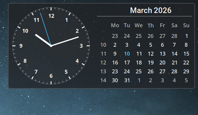

I’m sharing my custom Conky project called LACCC (Locale‑Aware Conky Clock & Calendar). It’s a modern, modular, Lua‑driven Conky setup designed to work reliably across all major desktop environments, including Wayland sessions.
The goal was to build a clean, transparent, locale‑aware clock and calendar widget that:
  • starts reliably on KDE, GNOME, XFCE, Cinnamon, MATE, LXQt, and others
  • works on both Wayland and X11
  • uses a modern, minimal visual style
  • is fully modular through Lua
  • is easy to extend with additional widgets
  • follows a consistent 2026 branding and structure
:package: Project structure
All files live in a single directory:
Code
~/.conky/calendar_clock/
 ├─ lacc.conf
 ├─ main.lua
 ├─ autostart.sh
 ├─ lua/
 │   ├─ clock.lua
 │   ├─ calendar.lua
 │   ├─ background.lua
 │   └─ text.lua

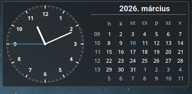

:artist_palette: Visual style
The widget uses:
  • a clean, transparent layout
  • modern typography
  • locale‑aware date formatting
  • Lua‑controlled background, shadow, and text rendering
  • a modular drawing pipeline

  • calendar.lua — calendar generation
    Locale‑Aware Conky Clock & Calendar (LACCC)
    CALENDAR MODULE – cal‑based multilingual engine with monthly cache
    Part of the 2026 ConkySystem Framework
    OVERVIEW
    This module renders a fully locale‑aware calendar using Cairo.
    It provides:
    • automatic language detection via system locale,
    • month and weekday names parsed from `cal`,
    • correct week start based on locale (no manual config),
    • monthly caching to avoid repeated external calls,
    • Cairo‑based rendering with gradients and alignment,
    • support for week numbers, outside‑month days, and today highlighting.

        -- MONTH NAME (from cal)
        local month_raw     = get_cal_monthname()
        local fmt           = cfg.month_format or "month_year"
        local month_name
        if fmt == "month_year" then
            month_name = month_raw
        else
            local ystr = tostring(year)
            local m = month_raw:gsub("%s*" .. ystr .. "%s*", "")
            month_name = ystr .. ". " .. m
        end
        draw_text(cr, {
            text   = month_name,
            x      = x + (cfg.show_weeknums and cw or 0) + cw * 3.5,
            y      = y,
            align  = "center",
            font   = "Roboto",
            size   = cfg.size + 8,
            weight = "bold",
            color  = cfg.color_month,

:framed_picture: Screenshots

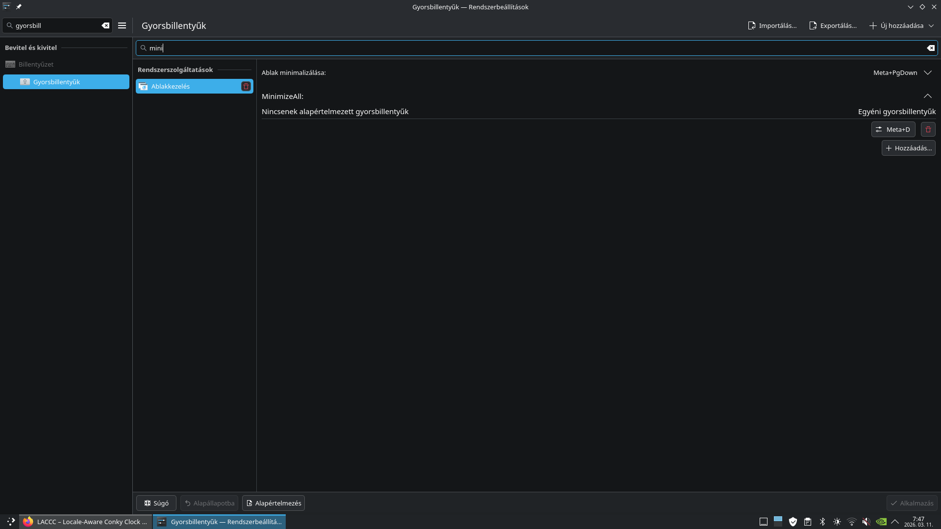

Works well with Plasma 6, but one KDE shortcut needs to be adjusted:
On Plasma 6 the default Win + D action is “Show Desktop”, not “Minimize All Windows”.
However, Plasma’s “Show Desktop” hides all windows, including Conky, so Conky appears to disappear.
To keep Conky visible, assign Win + D to “Minimize All Windows” instead:
System Settings → Shortcuts → Window Management → Minimize All Windows → assign Win + D
After this, Conky will stay on screen when you press Win + D.

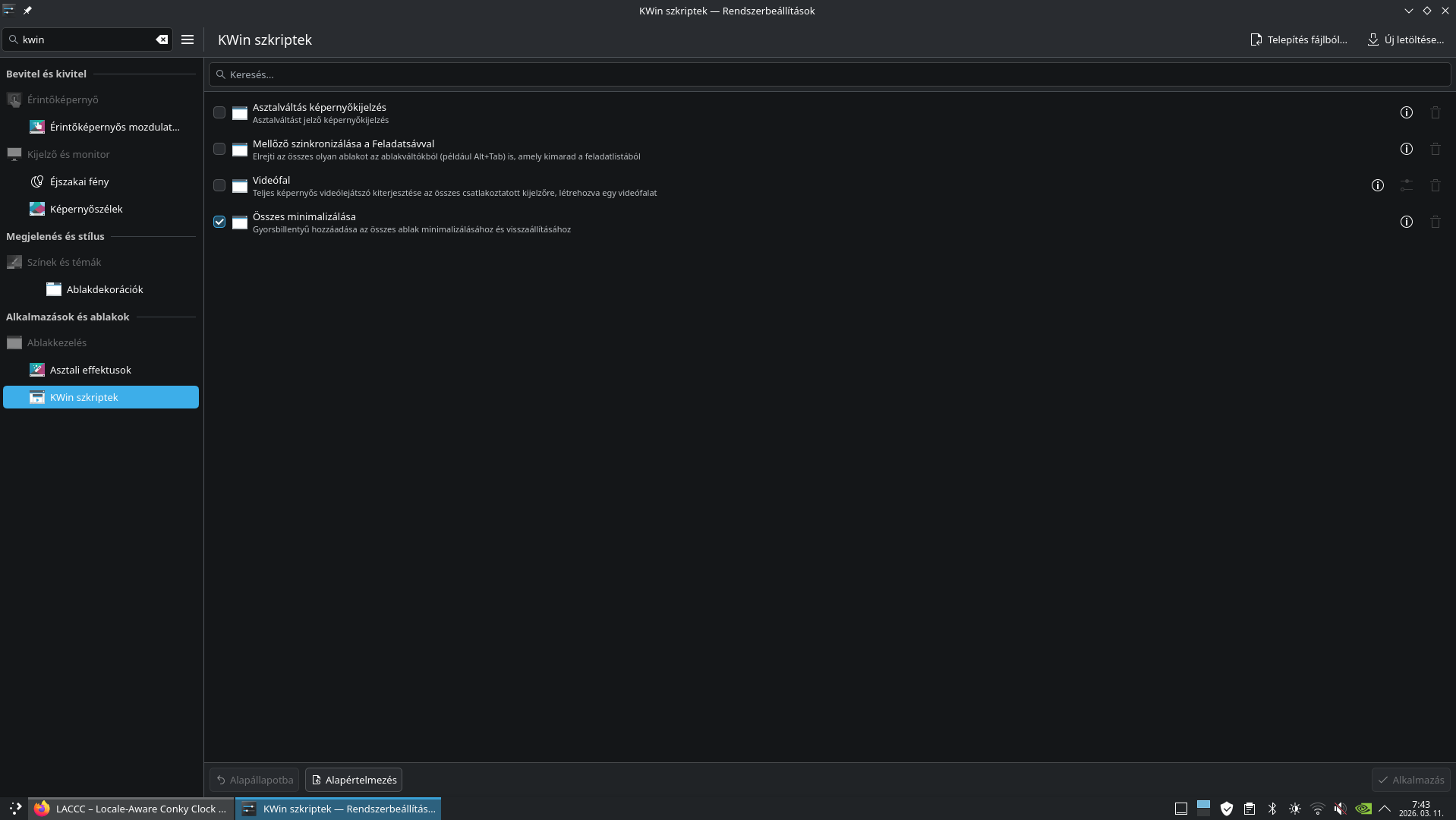

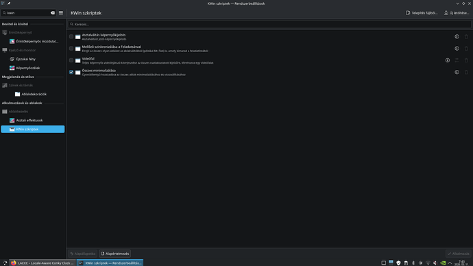

Wow - I used to have this shortcut on a mouse gesture with Plasma 5.
I cannot find ‘Minimize All Windows’ now!
First search kwin and enable it plasma5 Idont know but plasma 6 like works
Ah, ok thx - I’d disabled the kwin script so didn’t have a shortcut.
