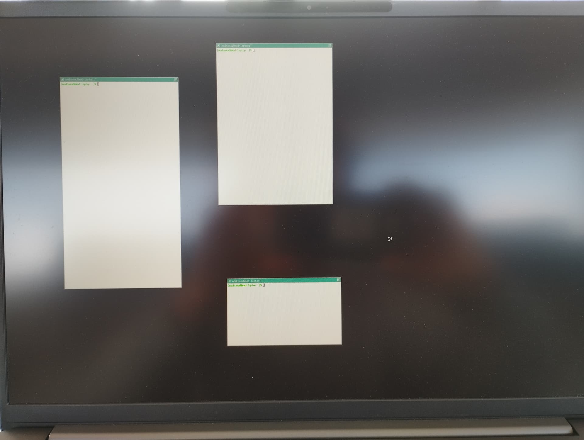

So, I followed your advices and I still get the same errors but startx takes me to this weird screen with three terminals:
:thinking:
ive never seen anything like that…
can you type something there, for example:
systemsettings
Well, it is a positive change because until now, startx was just responding KWin is unstable and it crashed several times in a row, so choose a different window manager. Now I don’t get that message at least!
When I write systemsettings in one of the terminals, I get "Cannot mix incompatible Qt library (5.15.7) with this library (5.15.8). Aborted (core dumped)

The log from the journalctl is huge (probably I got too many problems :sob:). I can only see this much on my screen:

output from pacman-mirrors is: “stable”.
I have no idea what that bbswitch is, actually!
so you had also an interrupted update…
post also output from:
and also from this, i compare it to mine:
pacman -Qs 'qt6|qt5|window'
the bbswitch was probably installed with optimus…
Oh, man, thanks a lot for your will to help!
pacman.log:

if you get stuck again, type startx, and if there are some logs, take a picture of it…

But I still get the same behavior and startx log is:
X.Org X Server 1.21.1.7
X Protocol Version 11, Revision 0
Current Operating System: Linux mad-laptop 5.15.93-1-MANJARO #1 SMP PREEMPT Thu Feb 9 12:13:18 UTC 2023 x86_64
Kernel command line: BOOT_IMAGE=/boot/vmlinuz-5.15-x86_64 root=UUID=e811d1dd-5c5a-4d5b-9786-900aa800c9e5 rw quiet udev.log_priority=3
Current version of pixman: 0.42.2
	Before reporting problems, check http://wiki.x.org
	to make sure that you have the latest version.
Markers: (--) probed, (**) from config file, (==) default setting,
	(++) from command line, (!!) notice, (II) informational,
	(WW) warning, (EE) error, (NI) not implemented, (??) unknown.
(==) Log file: "/var/log/Xorg.2.log", Time: Thu Feb 16 18:26:18 2023
(==) Using config directory: "/etc/X11/xorg.conf.d"
(==) Using system config directory "/usr/share/X11/xorg.conf.d"
/home/madnomad/.xinitrc: line 52: xclock: command not found
twm: created fontset with 2 fonts (15 missing) for "fixed"
xterm: cannot load font "-misc-fixed-medium-r-semicondensed--13-120-75-75-c-60-iso10646-1"
so this is the issue:
didnt noticed the -git when i recommended to uninstall it… you have it installed from aur and thats why you have:
so from TTY, try removing it with:
sudo pacman -Rdd qt5-declarative-git
any errors from it?
if not, and it removed the package, install it from official repos:
sudo pacman -S qt5-declarative
if no errors, reboot
