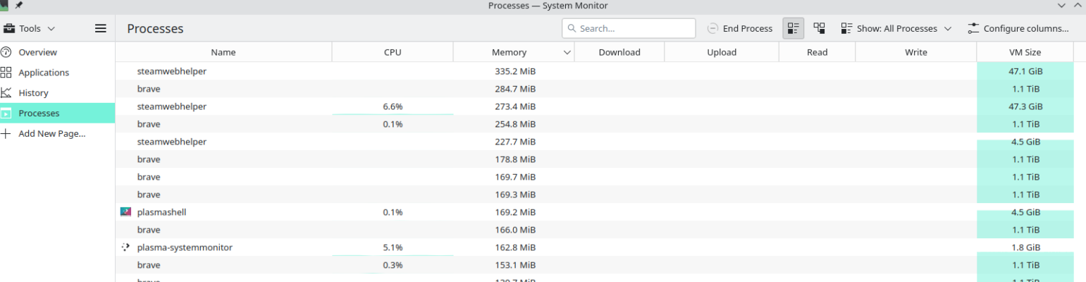

How do I know it’s updates related?
I’ve ran the command: …
journalctl --since '2024-02-16 10:46:00' --output='short-iso' --no-pager | grep -i -A 3 'BUG:' | grep -i 'kernel'
…to list just the kernel logs for the time range that starts way before the 2024-02-21 and later updates were installed. The output results start with timestamps matching the day of updates were installed.
Some of this command’s output:
2024-03-10T21:20:37+00:00 user123: BUG: kernel NULL pointer dereference, address: 0000000000000b33
2024-03-10T21:20:37+00:00 user123: #PF: supervisor read access in kernel mode
2024-03-10T21:20:37+00:00 user123: #PF: error_code(0x0000) - not-present page
2024-03-10T21:20:37+00:00 user123: PGD 0 P4D 0
2024-03-10T21:21:33+00:00 user123: watchdog: BUG: soft lockup - CPU#0 stuck for 26s! [kwin_x11:681]

Not sure what exactly to look for when checking the swap allocation, however, I did some testing of pushing the swap near the limits of 7.9 GB out of 8.8GB. So it doesn’t seem like there’s any usage threshold there that would trigger my issue.
Perhaps, it could be related to hardware in a way that the new, updated software is using it differently enough for usage to be unexpected?
I’m thinking so because I didn’t not have any Kernel BUG errors for an entire month (that’s how far I checked) before installing the mentioned Updates, but as soon as installed them, I started getting multiple of these Kernel BUG errors per day. Also I haven’t changed anything hardware related at all on this machine.
On a separate note, it may be worth adding that I doubt the issue is related to running out of memory. As most these issues happened close to ~4-5GB of RAM usage out of total 8GB available. Plus it happened a few times while having barely anything open at all.
Perhaps, there’s a way to track down what exactly ends up causing these kernel errors?

VM Size (probs red herring)
I’m aware that based on System Monitor’s description, the VM Size is nearly meaningless number, but is it normal for its size to be reported to be larger than the available system RAM or Storage?
For instance, the Brave browser reports VM Size of 1.1TB. I can assure you, there’s nothing 1TB sized on my system.
