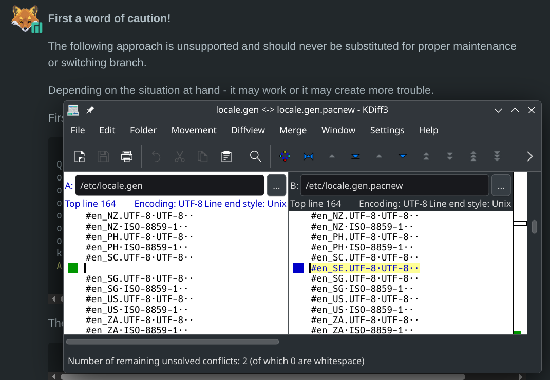

First I did a test on stable branch - running kdiff3 on a couple of files in /etc
 $ kdiff3 /etc/locale.gen /etc/locale.gen.pacnew
QFSFileEngine::open: No file name specified
org.kde.kdiff3: Loading A:  "/etc/locale.gen"
org.kde.kdiff3: Loading B:  "/etc/locale.gen.pacnew"
org.kde.kdiff3: Diff: A <-> B
org.kde.kdiff3: Linediff: A <-> B
org.kde.kdiff3: Enter: calcDiff3LineListUsingAB
org.kde.kdiff3: Leave: calcDiff3LineListUsingAB
kdiff3: /usr/src/debug/kdiff3/kdiff3-1.12.5/src/SourceData.cpp:179: LineType SourceData::getSizeLines() const: Assertion `m_normalData.m_pBuf != nullptr' failed.
Aborted                    (core dumped) kdiff3 /etc/locale.gen /etc/locale.gen.pacnew

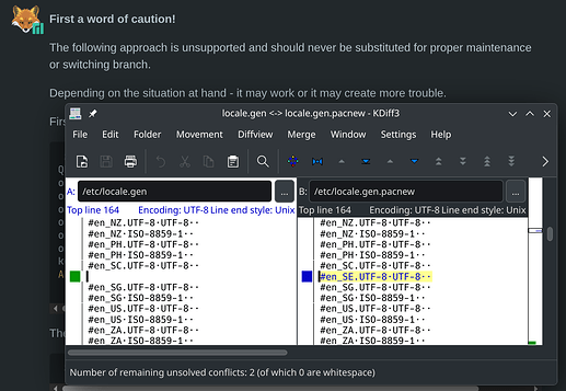

Then I pulled the 1.12.6 package
mind ye’all the mirror is not official in any capacity and you should not rely on it
 $ sudo pacman -U https://manjaro.dk/repo/pool/sync/kdiff3-1.12.6-1-x86_64.pkg.tar.zst
And reran the test
Then the kdiff3 application is working as expected.
In this situation it worked

I also confirm that on stable Manjaro KDE 2026-07-23 :
fixes the issue.
