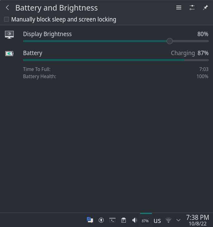

I’m on a PIneBook Pro, running Manjaro (which was pre-installed):
I’m sure power profiles were working on the KDE battery status indicator before, but they are not available anymore at time of writing:
power-profiles-daemon is executing correctly:

and the two available profiles can be listed:
> powerprofilesctl list
* balanced:
Driver: placeholder
power-saver:
Driver: placeholder
Any idea, please?

Same here on Pinebook Pro with Manjaro KDE (originally installed on the machine, fully upgraded since) : No power profiles available. (But I didn’t know they even existed, so I can’t tell if they were previously available).
