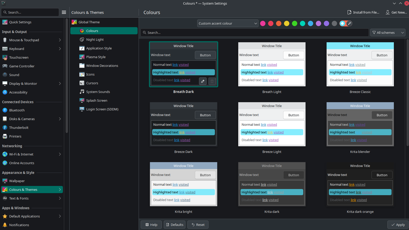

KDE Dolphin now uses black text on a dark background
KDE Dolphin now uses black text on a dark background in both stock dark themes (Breeze dark and Breath dark):
I’ve had this issue for a long time in certain third-party software, but I don’t think I’ve seen it in a core part of Plasma until this update.

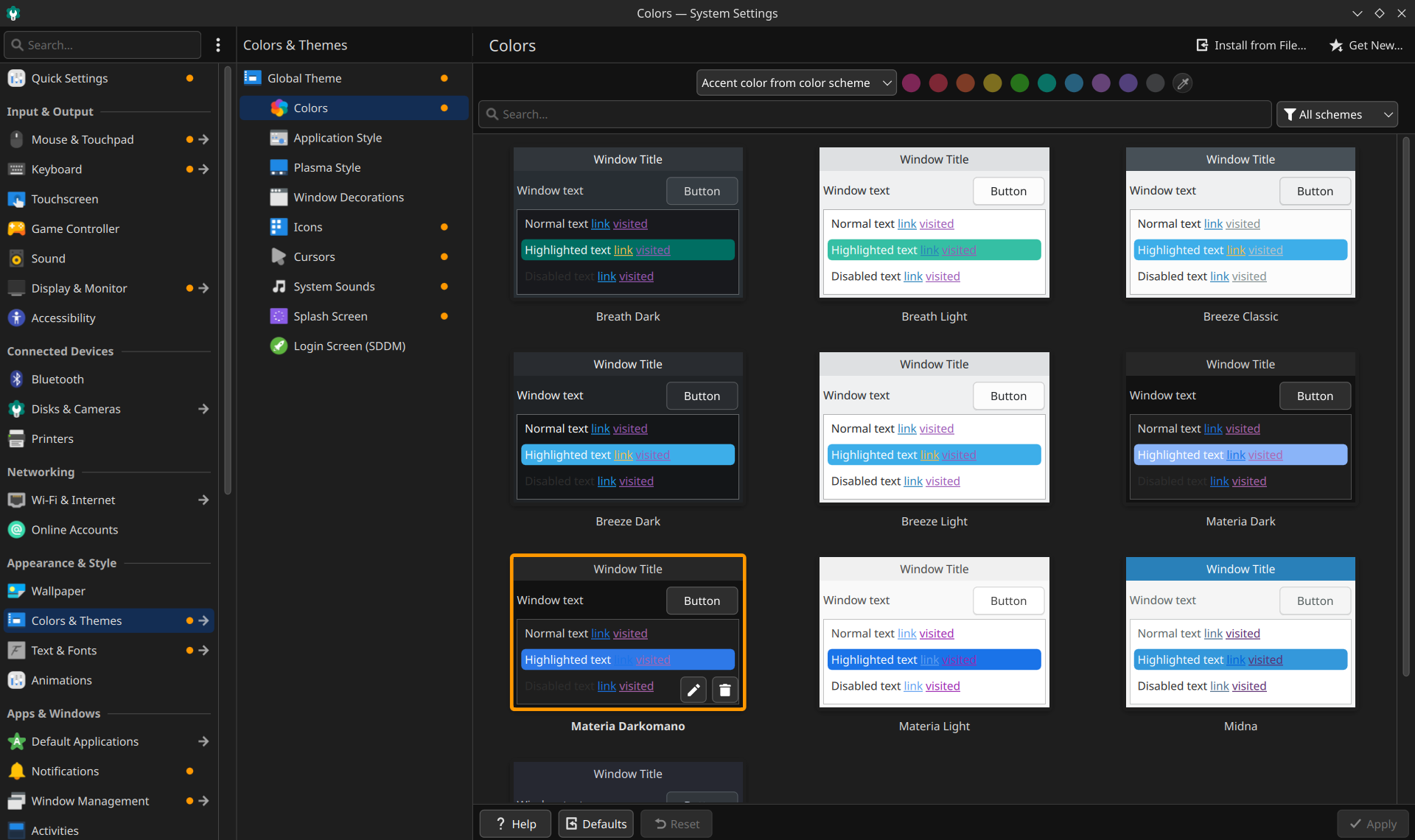

You may have a wrong color selected in settings. I don’t have issues on my side.
Which one do you have?

Thanks for moving this, and thanks all for the pointers. I’ve changed the setting at the top here:
from “Custom accent colour” to “Accent colour from colour scheme” and the problem was resolved.

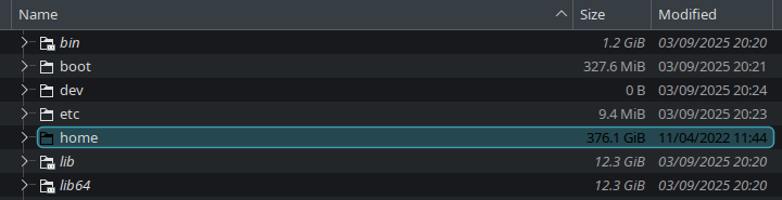

I did also make a test user which had the same issue despite not changing any of the theme or colour settings for them:
As this isn’t a wider issue I won’t investigate further, just mentioning because I thought it was odd.
