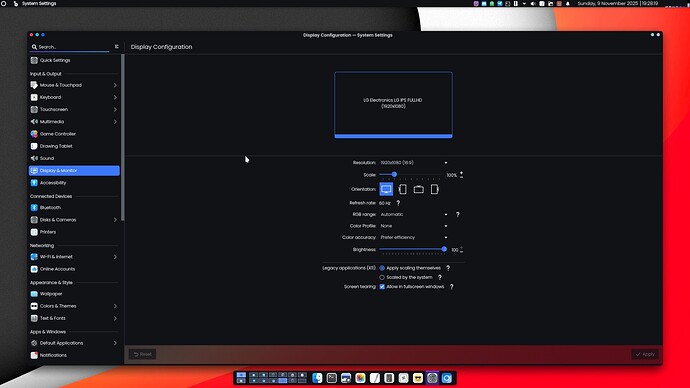

Installed the Gnome version a couple of days ago, twice my gnome-shell crashed when using OBS Project to record over night. Then waking up in the morning and my screen was blank. Had to login as root and kill my user session.
I login to Plasma Wayland to give this a try, but my Two Screen Display setting did not transfer over. I need to change my Two Display Screens like you would normally, but I can not find the Display Settings like you would in KDE.
Where is it?

That is where I normally would find it, I came from and still use it, a Leap KDE user, but I don’t have that menu option. In addition for some reason I can not do a Screen Shot to show you how this Section looks.
Does this mean I need to do Fresh Install with the KDE version or is there something else I can do without a New Install?

The initial install was Gnome and I made no additional KDE GUI install, except for some utility applications like (Dolphin, Kate, etc.,). I installed the Gnome version, because I wanted to use some of the Gnome Extensions, like my Lab Server which is a Red Hat (only provides Gnome), and OBS is working normally.
Well, I will just do a New Install using the KDE Version, because I keep getting these type of coredumps:

I’m a KDE user myself, but judging from your comments (the Lab Server, and that OBS is working normally) you might be better served preforming a fresh install of GNOME, instead.

Never ever install Gnome and KDE together and use the same user for both. They are very incompatible and all kinds of strange problems will arise.
At least make a separate user for kde.
Although i personally would not mix even in that way.
And to change the whole DE to fix a program is kind a strange idea. You could have tried with other version of the program first.

If both desktop environments are installed in parallel then you will face issues primarily related to conflicting configurations for things like display management, audio and theming, which are handled differently by each DE. Very hard to fix, in those cases I would recommend a reinstallation. Wouldn’t be surprised if this is the core of your issues.
If you believe to require both DE’s you could spent a dedicated partition to each (one for Gnome, one for Plasma) and have them installed separately. They could share the rest of the discs like ESP, swap and even data partitions. For the system partition usually only about 20 - 30 GiB are suffient so this won’t take much ressources.
After running os-prober you could switch between them via grub’s boot menu.
