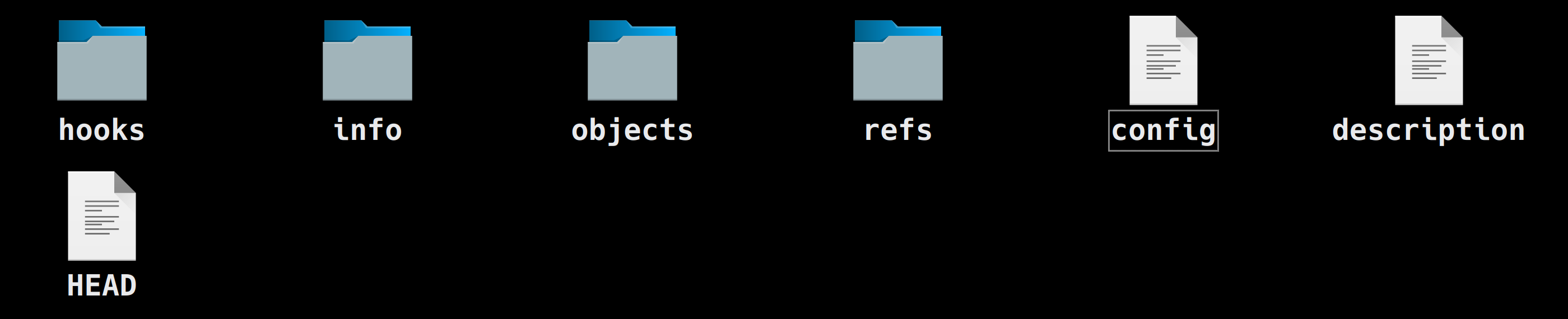

The only thing I did was created the folder it saves too, the folder has these in it when finished. Tje odd thing it says it can’t read /home
in the log.
Did it work well before you created that folder? :thinking:
