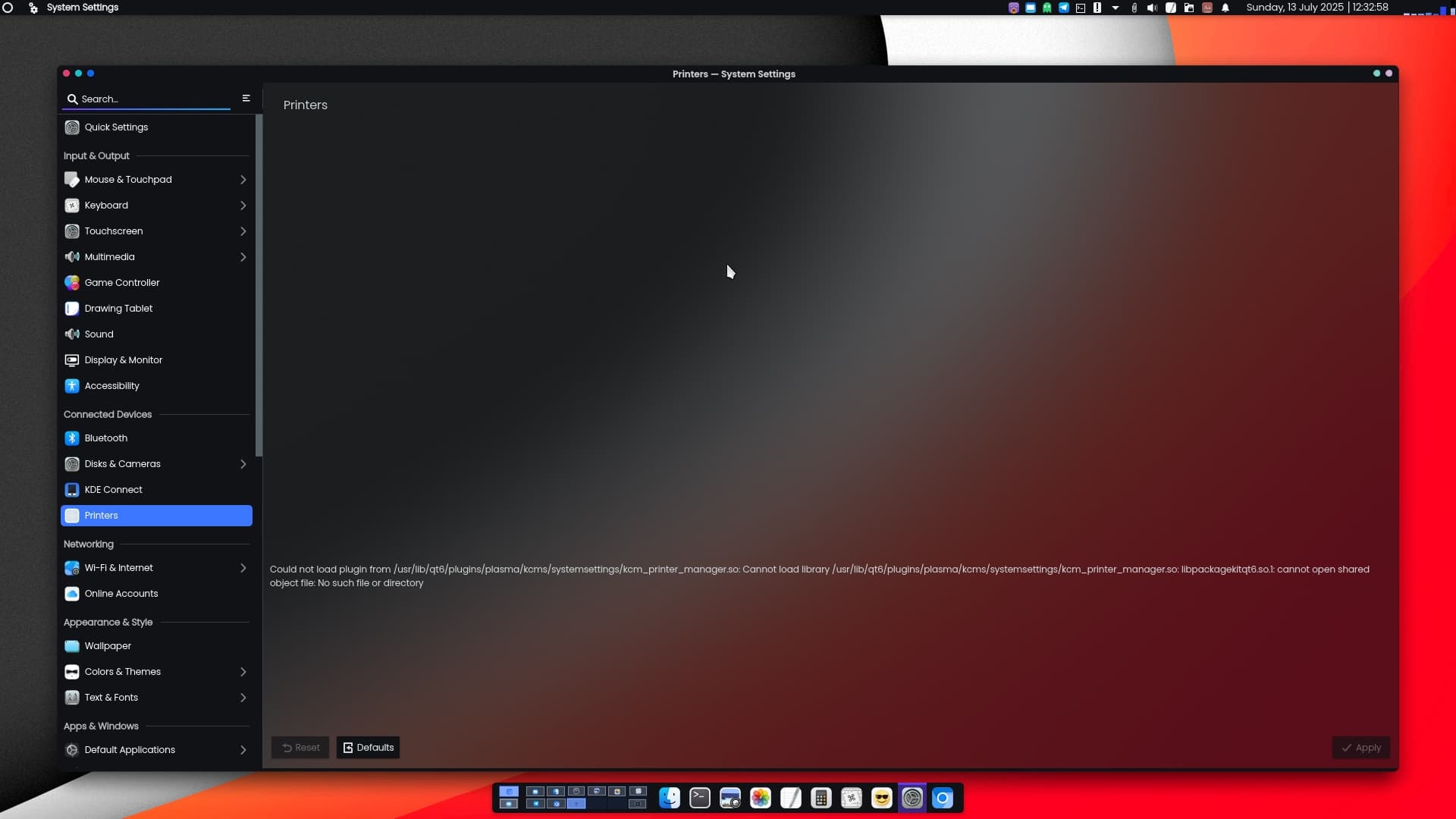

July update broke the printer manager in KDE/systemsettings on all my computers here, missing “libpackagekitqt6.so.1” dependency.
I had to install “packagekit-qt6” (and packagekit as dependency) to make it work again.
If it can help someone…

Ah, but you’re on the Unstable branch, with Plasma 6.4. We are on the Stable branch, with Plasma 6.3.6.
In that case - you will just have to wait until 6.4 hits the fan.
Well, it’s not a problem for myself as I don’t have any printers connected to this machine, but it’s rather unfortunate for those who do, especially since the error message throws up the suggestion that one should install packagekit in order to remedy the problem.

It needs -DSCP_INSTALL=off in config. CMakeLists.txt · master · Plasma / Print Manager · GitLab
Build CI installs packages not in a clean chroot.
Fixed with print-manager 1:6.3.6-2 coming along shortly.
