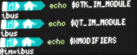

Input Method related envvars:
those are being set at the top of my ~/.profile
export GTK_IM_MODULE=ibus
export QT_IM_MODULE=ibus
export XMODIFIERS=@im=ibus

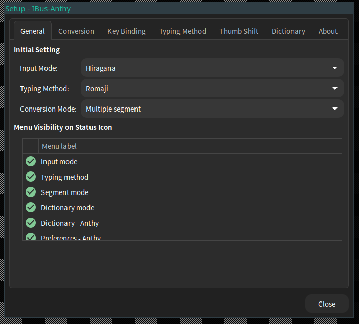

ibus config
anthy config
(I already tried changing those key bindings several times and it didn’t change anything)
