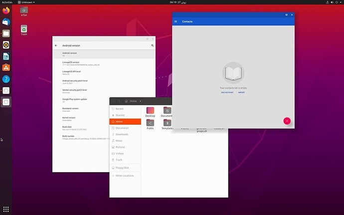

have you heard of waydroid? It’s an Anbox fork.
I was reading the above mentioned article and I found
The main catch right now is that there’s no emulation layer in WayDroid, so x86 devices (like most PCs) can only run x86 binaries, and ARM64 devices (most phones and tablets) can only run ARM64 binaries. This is similar to how the Wine compatibility layer works — even though Wine is available for Android, it can’t run most Windows software on most Android devices, since phones are typically ARM and most Windows software is x86-only. The developer is hoping to implement emulation in the future by using components from the Android subsystem for Windows 11.
