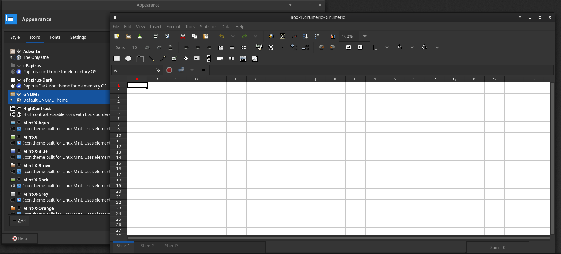

I’m running Gnumeric 1.12.50 on Manjaro Linux 21.1.0 (Pahvo) with XFCE and the UI looks like this

As you can clearly see (pun intended) that the toolbar icons/buttons are indistinguishable.
What should be done to remedy this?
Hello,
While we appreciate you taking the time to open an issue, we also would appreciate if was the case to open it … and that was the wrong place to do it. Is unrelated to Gnumeric … and also is unrelated to Manjaro.
Take a look at your default theme in Settings > Appearance > Style and also take a look at the default icons. If you are using a dark theme, then use the dark icons. With Adwaita-dark that you use, then the icons have to be the dark version … It works even with the default Gnome icons.
