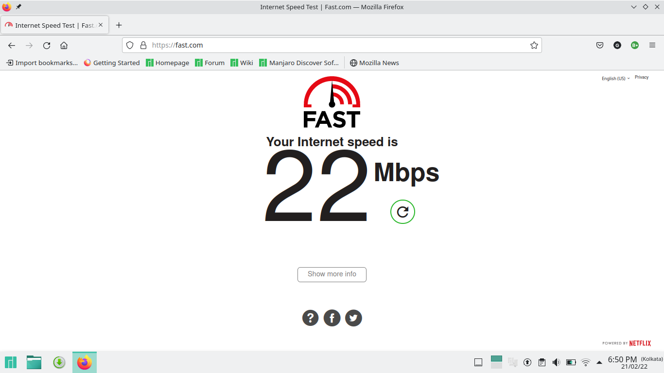

I did it and rebooted .Here is the result
I think it increased by 2-3 Mbps .

I checked the Internet speed on my phone ,it was same as that on laptop 23 Mbps . I think speed is probably slowed by my Isp or maybe it is slow due to multiple device connections .
