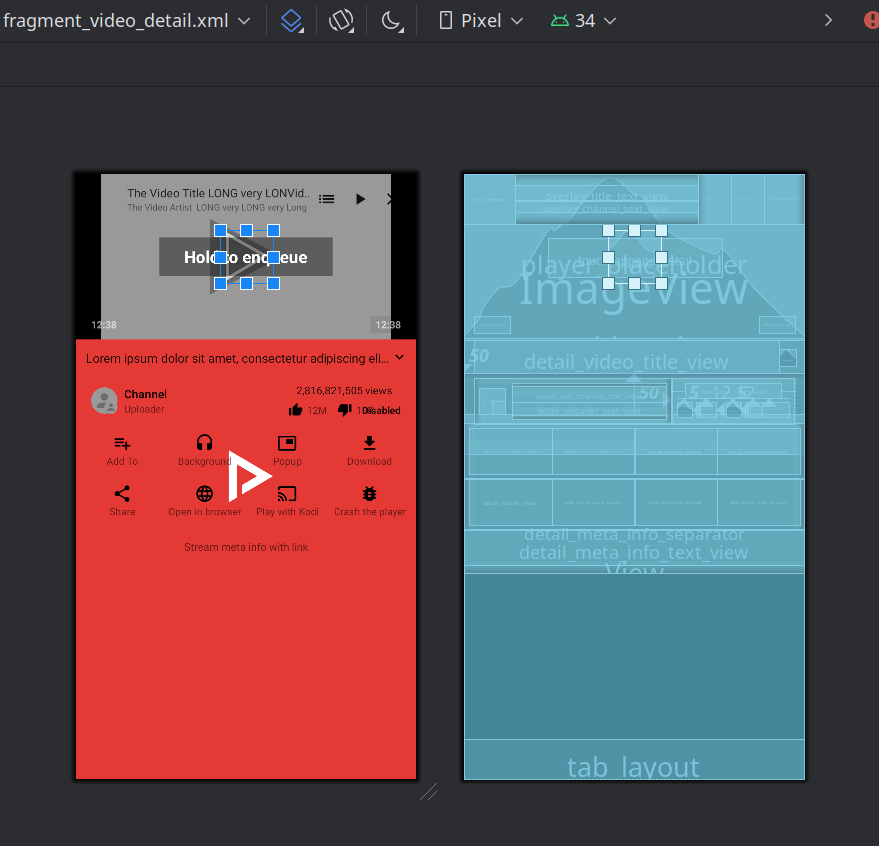

What is the layout view - is it some kind of UI drag’n’drop composer?

the layout view shows in graphics the appearance of a layout. I attached a screenshot.

When using Intellij for code editing, there appears no problem with the new version of xwayland, it only happens when the graphic view is opened (appears to me).
