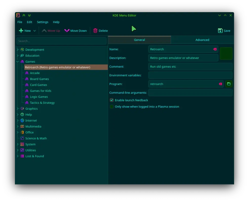

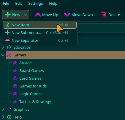

Right click on the Application Launcher icon and select “Edit Applications” (or run kmenuedit from a terminal).
Then highlight the Games section, click on the “:plus: New” option at the top of the window, and select “New Item”:
When the input box pops up, enter the name of the application (eg Retroarch). OK that, and you will then be able to enter the details for the application:
Make sure you save it, and it should now be in your application menu.
Thanks…
After I manually added Retroarch into menu, Steam magically appeared in Games menu.
I guess it is an issue with current Flatpak of Retroarch…
