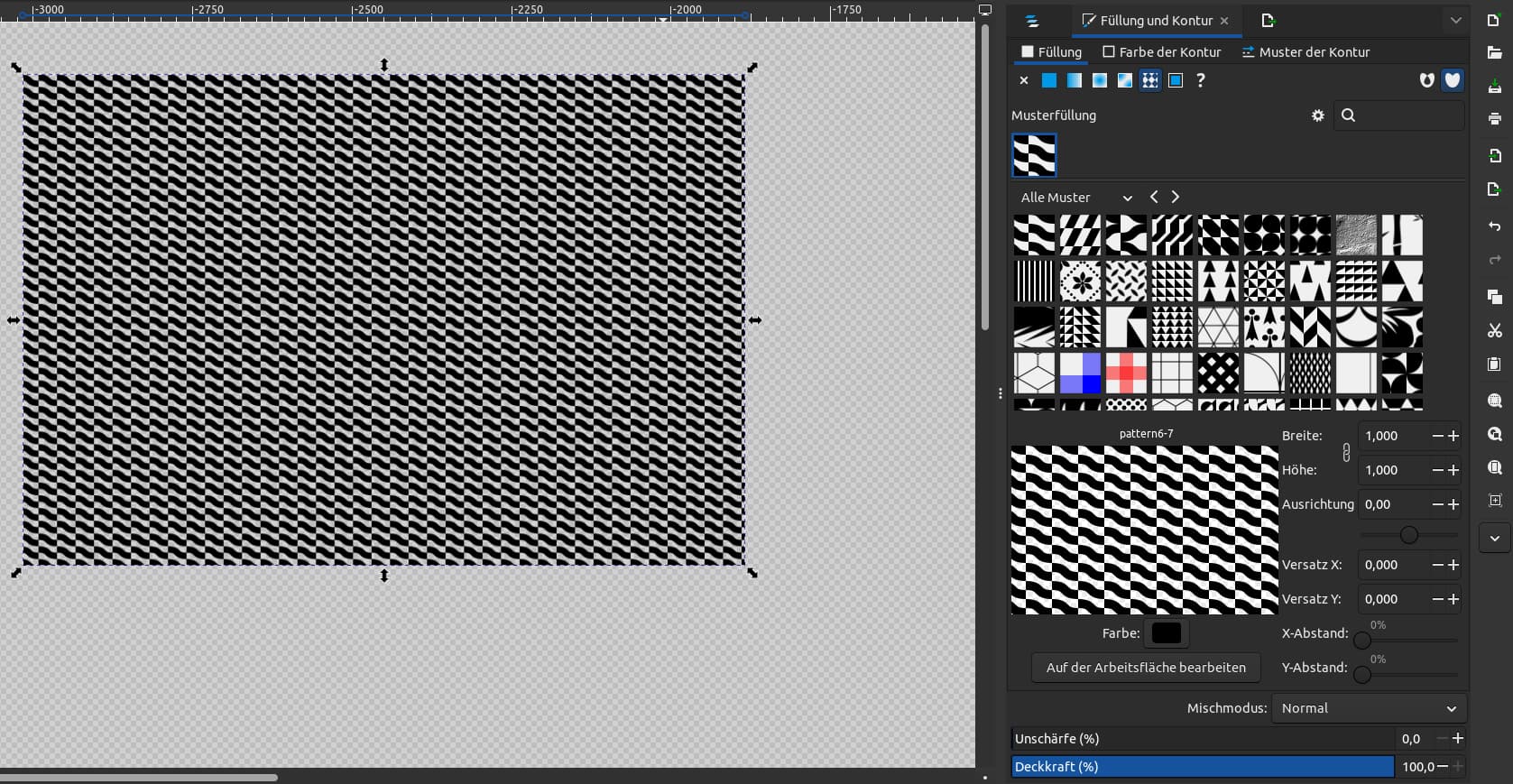

Hi folks,
I encountered the following issue with Inkscape on one of my Manjaro installs:
Steps to reproduce:
  1. Select an object on the canvas
  2. Select ‘Fill and stroke’
  3. Select ‘Pattern fill’
  4. Manipulate opacity slider (or anything in that area)

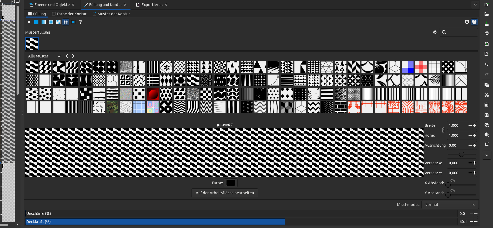

As you manipulate the slider, the sidebar grows. It cannot be resized back down until a restart of Inkscape.
This problem occurs only with the Manjaro package and not with the official Flatpak or AppImage. It occurs only on one specific Manjaro install. Thus, I deduced it might have something to do with my configurations. However, deleting ‘preferences.xml’ does not fix the issue. Neither does removing Inkscape via sh sudo pacman -Rn .
Consequently, I am wondering whether there is anything left to try.

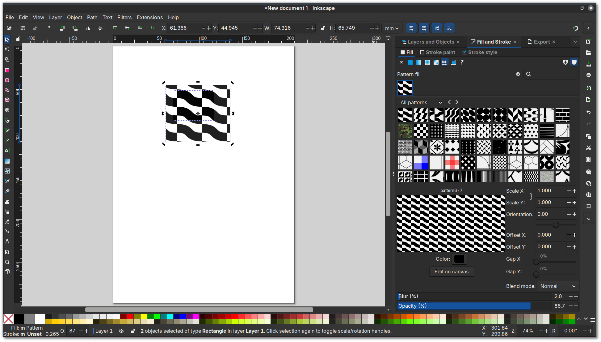

I just tried this on my system, I have the AppImage version installed and it does not have this issue.
Maybe download the AppImage version and see if it does it.
