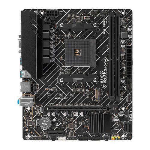

I think that sounds like a motherboard issue. What manufacturer is your motherboard? Is your BIOS up to date?
From your original post I see it’s an AMD A520 with firmware from 2012, and AMD’s website has a chipset and RAID firmware update, the manufacturer’s website may have more. You might be able to update them through fwupd in Linux, but, chances are you’ll have to have Windows installed to update them.
It might be worth it to pull out the CMOS battery, hold the power button for 30 seconds, plug it back in.
So, I would go to your motherboard’s manufacturer’s website, and update everything you can.
Oh, so sorry @tracyanne It wasn’t my intention.
It is exactly this model from this manufacturer. I recently updated the BIOS as well in case I was looking for any errors, but I didn’t notice any difference.
