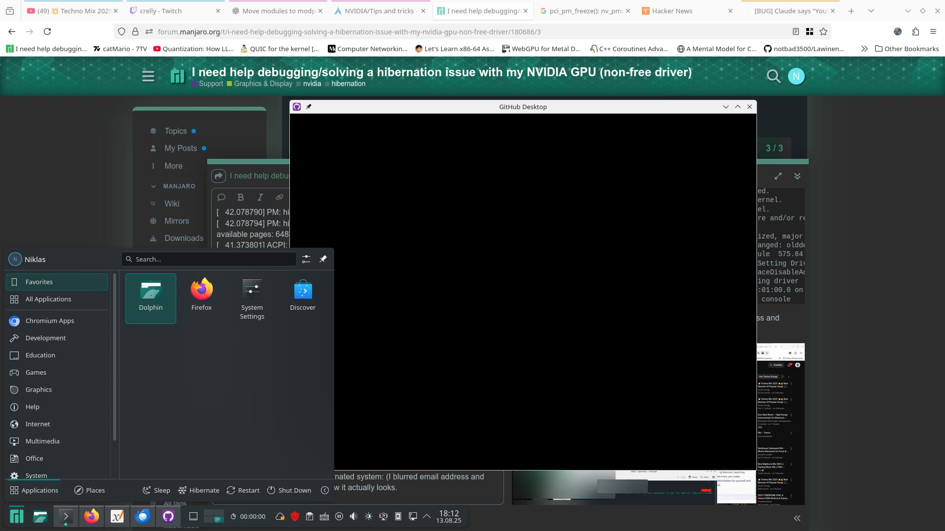

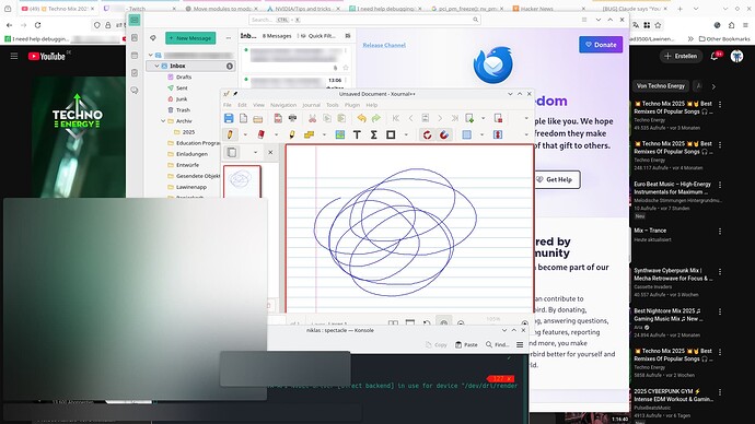

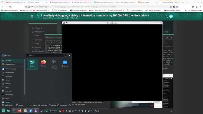

I couldn’t see any errors in the boot previous to the memory corruption issues, it looked just like that one (same hibernate lines).
Funnily enough I found that if I disable this option (See ArchWiki as source to why you would need it: NVIDIA/Tips and tricks - ArchWiki), the system hibernates.
Only problem is though that electron apps become black windows and plasmashell stops working after you log in.
Apps like xournalpp were restored perfectly though.
options nvidia_drm modeset=1 fbdev=1
options nvidia NVreg_PreserveVideoMemoryAllocations=0
#options nvidia NVreg_PreserveVideoMemoryAllocations=1
options nvidia NVreg_TemporaryFilePath=/var/tmp

I tried one more time after an unsuccessful boot and changed the file to:
#options nvidia NVreg_TemporaryFilePath=/var/tmp
This is a screenshot of a the hibernated system: (I blurred email address and names but the plasma “blur” is how it actually looks.
This time I was able to run:
plasmashell --replace &
Checking the logs plasmashell did not throw a Graphics Exception (just kwin_wayland?):
# Everything else is the same
[   79.576981] NVRM: Xid (PCI:0000:01:00): 13, Graphics Exception: Shader Program Header 11 Error
[   79.576986] NVRM: Xid (PCI:0000:01:00): 13, Graphics Exception: Shader Program Header 18 Error
[   84.726952] NVRM: Xid (PCI:0000:01:00): 13, pid=1438, name=kwin_wayland, Graphics Exception: Shader Program Header 11 Error
[   84.726982] NVRM: Xid (PCI:0000:01:00): 13, pid=1438, name=kwin_wayland, Graphics Exception: Shader Program Header 18 Error
[   92.575043] NVRM: Xid (PCI:0000:01:00): 13, Graphics Exception: Shader Program Header 11 Error
[   92.575130] NVRM: Xid (PCI:0000:01:00): 13, Graphics Exception: Shader Program Header 18 Error
[   92.648864] NVRM: Xid (PCI:0000:01:00): 13, Graphics Exception: Shader Program Header 11 Error
[   92.648965] NVRM: Xid (PCI:0000:01:00): 13, Graphics Exception: Shader Program Header 18 Error
[  112.123663] NVRM: Xid (PCI:0000:01:00): 13, Graphics Exception: Shader Program Header 11 Error
[  112.123770] NVRM: Xid (PCI:0000:01:00): 13, Graphics Exception: Shader Program Header 18 Error
[  112.562583] NVRM: Xid (PCI:0000:01:00): 13, Graphics Exception: Shader Program Header 11 Error
[  112.562589] NVRM: Xid (PCI:0000:01:00): 13, Graphics Exception: Shader Program Header 18 Error
Which allowed me to get my system back but the electron application stays dead/black:
I rebooted after this one and hibernated again (and then hibernated that system once more) which had the same outcome (plasmashell --replace wasn’t immediately possible but after 20s it replaced the broken instance).
The electron application was dead, i needed to force close it but restarting it after that was possible as if nothing happened.

Also somehow when I just tried again without the option:
it hibernated fine, but it seemed to take a little bit longer.
It also didn’t kill the electron application (window was black until I entered with my mouse), … until I hibernated once more and then the electron application died again.
So I guess the only problem I have now is electron applications dying (which I don’t really care that much about) and the plasmashell death which is kinda annoying.
