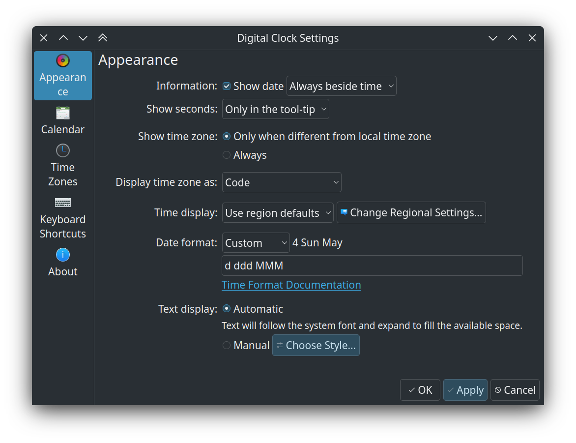

I cant remove this "|" in the date/time of the KDE digital clock?

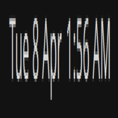

This is what the digital tray clock looks like since an update quite a while ago now.
I’v tried to remove the “|” several times in the last few weeks but just gave up.
I have looked at all the other clock widgets but none of them can help
This is my third attempt at fixing it, but this time I shall ask for help.
I just want the date - time in a single row. I do not want the “|” in it.

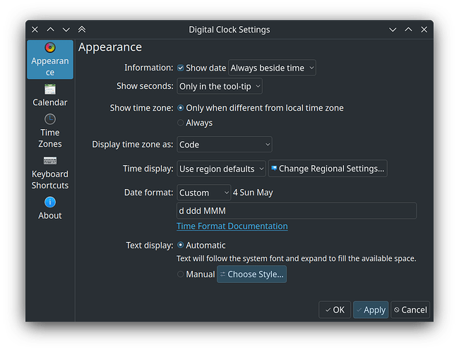

Below are my current settings for the digital clock.

Yea, I was going to refer to it as a pipe too, but the odd thing was that when I added a pipe directly to the format string it was not the same, so I assumed it must have been a separator of some design.
Here is a pipe alongside the problematic character:-
