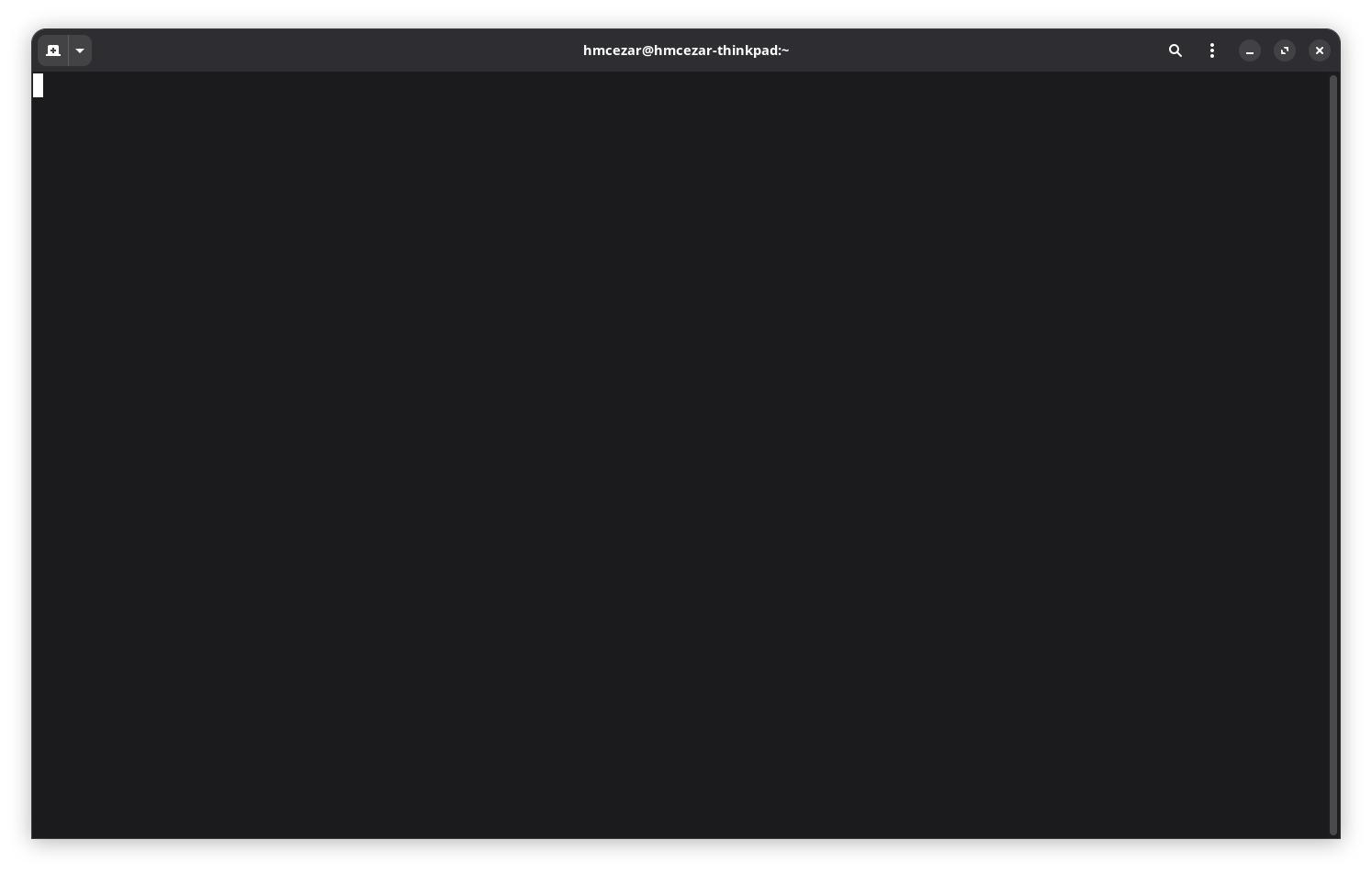

I can login to GNOME, but Terminal and even TTY does not work
Something weird just happened after a reboot, where I cannot login even to a TTY, but I am logged in on GNOME.
I did not apply the latest update yet, in fact, I was trying to login to a TTY to update.
I tried using the login to the TTY but it’s just there hanging.

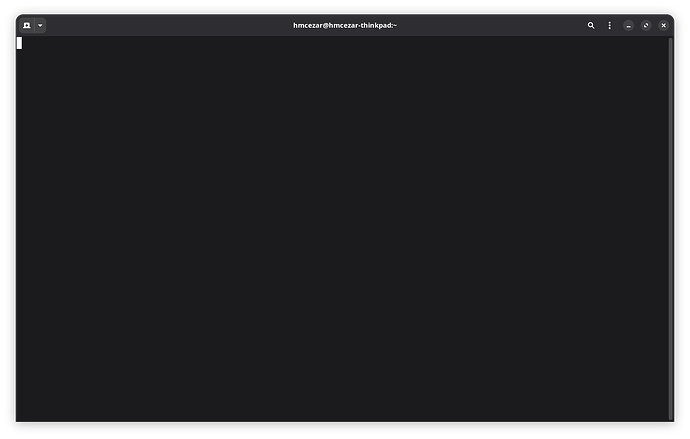

If I try to use something that uses VTE or even XTerm, it just hangs in there:
I did not change my .bashrc/.zshrc or .profile since the last time it was working.
Any ideas of what should I do to have access to a terminal again? I really need it to ssh to other machines and work.

Ok, apparently the problem is really one of them.
I managed to boot into runlevel 3 as @Zauberer-Merlin suggested and updated the system from there, however I still had the same problem with the terminals.
Then, I tried logging in as root in a TTY and it worked in a normal boot, but my user was still hanging after I typed my password.
Finally, I renamed my .bashrc and .zshrc and tried opening Terminal and it worked. So likely something there is causing the problem. Thank you for your help.
Now I need to figure out what exactly is going on.
