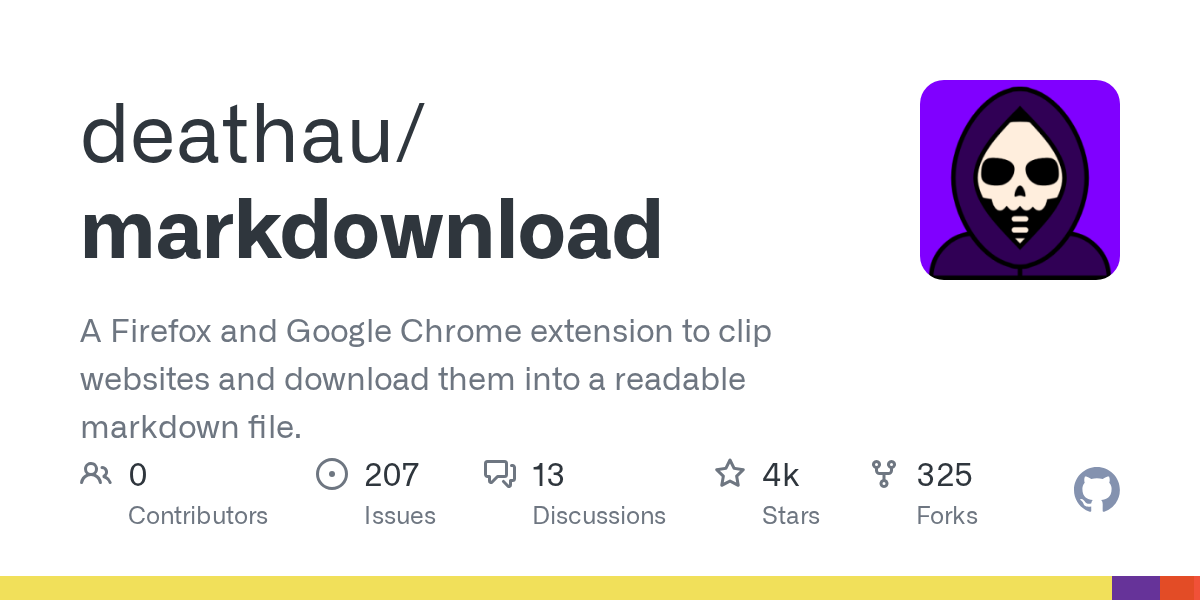

:brain: You can download entire web pages as Markdown documents.
Ya, you can’t find the Plasma installation guide… that’s just criminal - you can be flogged for such behavior :rofl:
I like this extension to grab web pages and save them to my ‘Notes’ folder.

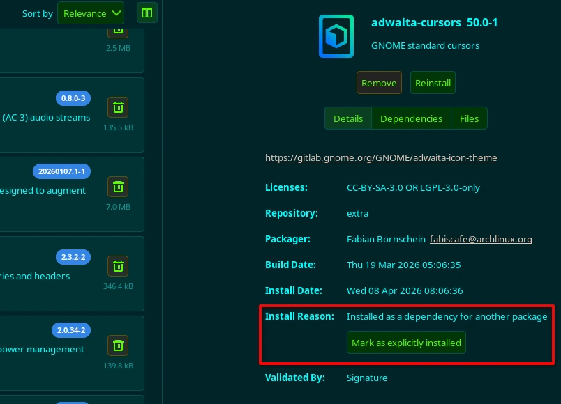

Further to @Teo’s post (which I concur with as probably being the simplest & quickest way to remove the bloat from your system), in pamac’s GUI you can manually change packages that you want to keep, but which were installed as dependencies of other packages, to “explicitly installed”.
I don’t have any orphan packages, so I just found another package installed as a dependency for this screenshot:
So, after you remove one or more -meta packages, you can open the Installed → Orphans section of pamac-manager (the GUI), browse for packages you want to retain, mark them as “explicitly installed”, and then remove the rest of the orphans.
You can also use the CLI to mark packages as explicitly installed via pacman:
sudo pacman -D --asexplicit the-package-names
pacman -D --help
