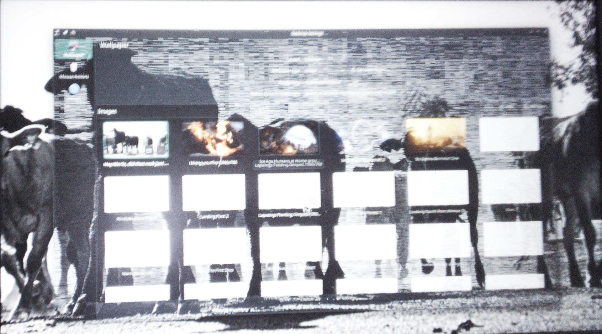

I am experiencing extreme screen tearing when running on Internal NVME SSD
This may not actually be a Graphics issue.
When running on an external USB SSD, I do not experience this issue.
Here’s the computer details.

This is currently running on the external SSD. Both the internal and external SSDs have the same version of Manjaro installed from the same USB key.
smartctl reports the nvme health is good

There was something recently about mesa and Intel graphics, and a few topics complaining about severe screen tearing. In one of the update announcements I recall the suggestion to revert to the previous mesa (apparently a known issue).
I only saw this in passing and as it didn’t apply to me, I largely dismissed it, but it might be worth following up.
Raptor lake U is a 13th gen cpu. It is not that.
The only thing that comes to mind right off the bat is this:
In this case, I’d take a look at the motherboard manual.
Sometimes PCIe lanes are shared; the manual might state that if you install an SSD in a specific slot, you can’t install PCIe cards in another one — otherwise, you’ll run into issues.
My motherboard definitely has warnings like that in the manual, and I had to do quite a bit of juggling to get everything connected correctly.
:footprints:
I will second that. Your description of the problem sounds very much like an interference issue to me. Perhaps best to shuffle your PCIe devices around to other slots.
The thing is it started, after I rebooted the Laptop, after installing the kernel 7.1 RC, and booted on to that.
After that it did not matter what kernel I booted on to.
Even after I reinstalled the OS on the internal NVME
The only exception is it doesn’t do it on the external USB SSD.
I suppose it could be the solution described.
Well, I’d put that down to coincidence. I’m pretty sure it’s “chatter”, as they call it — electrostatic/electromagnetic interference. There’s a reason why they put the UTP cables for the machines on a professional LAN in separate conduits. :wink:
Things like this can easily be influenced or even triggered by atmospheric conditions. Most people don’t realize this, but unless you’ve got a professional system with ECC on everything — and those machines cost a fortune; trust me — your computer and even smartphones, cellphones, radios and television sets are incredibly susceptible to this kind of interference.
Probably.
At the moment it’s kinda confusing. Because it works perfectly on the external SSD. Which I suppose could point to a Hardware issue, you guys have described.
Well, it’s a no-brainer, really. When you’re running off the internal drive, there is more activity on that PCIe slot, and the temperature will be higher there, which could be the trigger.
When running from the external drive, the devices are sufficiently separated and there is no crosstalk.
It is really strange - that you get notably different experience using the internal disk.

This is what the tearing looks like, if anyone is interested. it happens when I move the mouse, and only in Windows, including the Panels.
I am completely at loss - this is really really strange - the fact that the system work with tearing when using an external disk.
If it were me I would be going totally bonkers trying to solve it.
I cannot fathom what difference that would make - except for some weird circuitry issue - but then - it would have been so from day one - please say it didn’t occur from day one :slight_smile:
