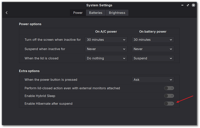

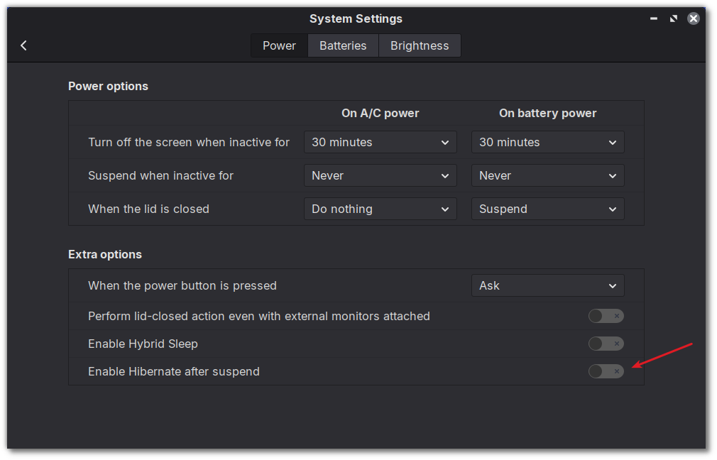

The gist of it from my experience is that If you have a swap partition already setup properly and hibernation works by itself, your desktop environment should have an option for “suspend-then-hibernate” sort of behaviour.

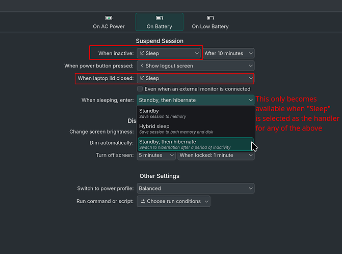

I have not used Cinnamon but on KDE it works like: If you have sleep as the handler for any event, it provides you option to choose what kind of sleep mode you prefer. The way this is exposed can vary for each DE.
From a random search I did, there is a similar toggle in Cinnamon power settings to enable this behaviour it seems, you should look into any Cinnamon docs you can find just to confirm.

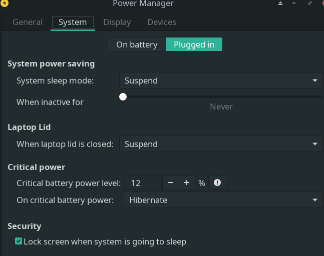

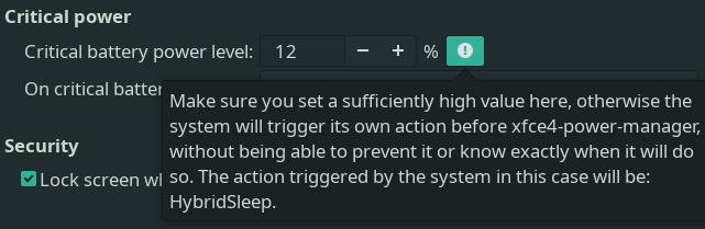

Here is how it looks on xfce - obviously there is the setting in xfce and then systemd which should work by default.
