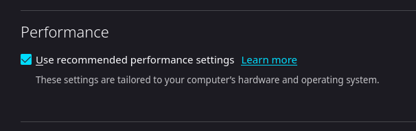

Supposedly under firefox Edit → Settings there is a checkbox to enable/disable HW decoding when checked I see that HW is forced and mp4 vids will not play. If you uncheck it and then uncheck the new Force HW if available then mp4 vids will play with SW decoding.
Here the box is checked and the vid plays with only ffmpeg-rpi installed:

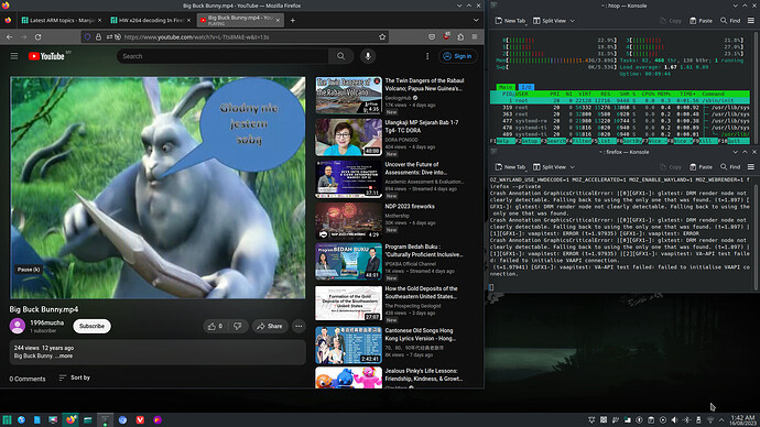

Device GT King Pro (S922X), confirm with ffmpeg-m2m, Firefox 116.0.1 can stream https://youtu.be/L-Tts8MkE-w?t=13 but I don’t think it is vpu hw accelerated based on the CPU resources used.
QT_QPA_PLATFORM=wayland GDK_BACKEND=wayland MOZ_ENABLE_V4L2=1 M
OZ_WAYLAND_USE_HWDECODE=1 MOZ_ACCELERATED=1 MOZ_ENABLE_WAYLAND=1 MOZ_WEBRENDER=1 f
irefox --private

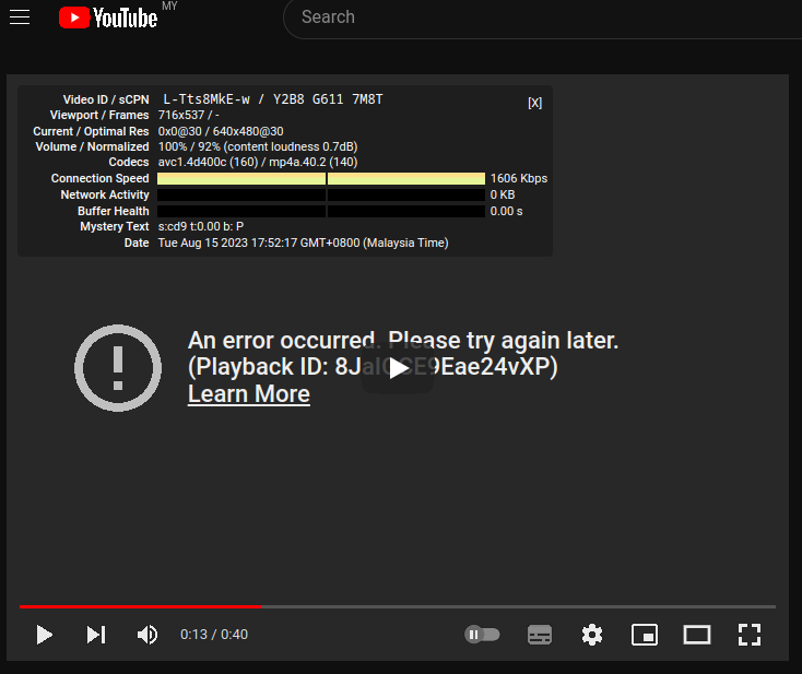

Tried to stream the same Buck Bunny mp4 on the latest Vivaldi-Stable (ffmpeg-m2m) result with error.
Vivaldi-Stable on Manjaro-Arm-KDE-linux-aml-6.1.42-1 with ffmpeg-m2m
What does it take to make Firefox 116 enable vpu hw acceleration?

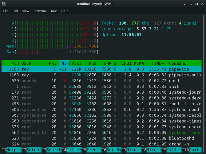

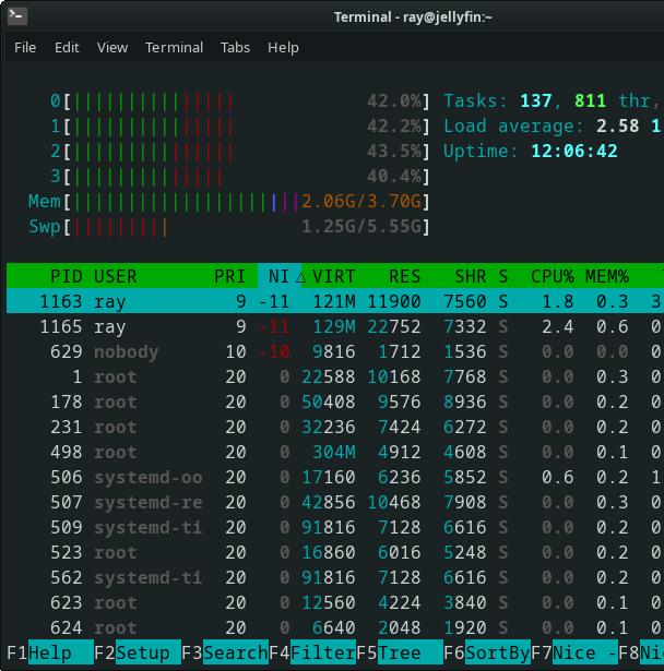

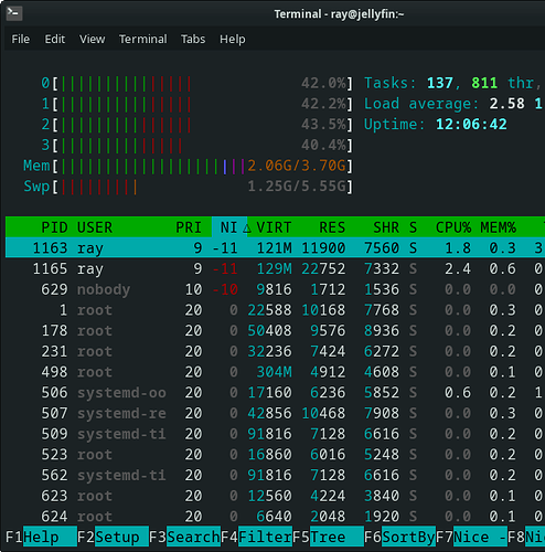

I was at that point yesterday but had to leave for the rest of the day. Today I can confirm there is HW decoding by comparing ffmpeg6 SW and ffmpeg-rpi 4.4 in htop.
I am seeing about a 50% drop in cpu usage with the big bunny vid with ffmpeg-rpi. I believe it is like when I was using MMAL (opensource) years ago on the 32bit pi image where it was using HW at a higher level where the omxplayer was able to directly access the vpu directly using the code.
ffmpeg6 SW:
ffmpeg-rpi 4.4:

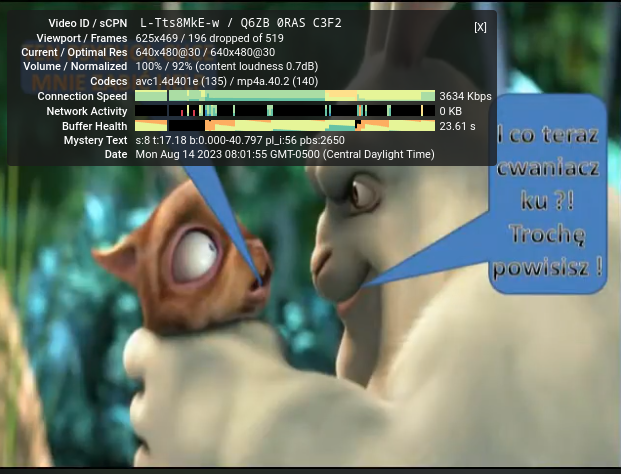

On my device Manjaro-Arm-KDE-linux-aml-6.1.42-1 ffmpeg-m2m and Firefox 116.0.1 streaming Big Buck Bunny mpv, the CPU resources used is a bit lower.
Your 6 cores vs my 4 overclocked @2150. lol
Based on memory, on the previous mpv-hwdec version and ffmpeg-m2m, streaming 1080p/60 mp4 with vpu hw acceleration, the cpu resources used is similar or lower than above case. Which lead me to assume NO vpu hw acceleration on Firefox 116 with ffmpeg-m2m as the resolution of Big Bug Bunny mp4 is only (640x480) significantly lower resolution compared to 1080p/60.
For your info, Fedora 38 Workstation Firefox 116.0 with ffmpeg-6.0 would not stream Big Buck Bunny mp4 – same result as Vivaldi-Stable with ffmpeg-m2m.
