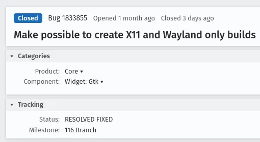

I think the bit for compilation time you are interested in may be this:
if CONFIG['MOZ_ENABLE_VAAPI'] or CONFIG['MOZ_ENABLE_V4L2']:
  UNIFIED_SOURCES += ['../FFmpegVideoFramePool.cpp']
  LOCAL_INCLUDES += ['/third_party/drm/drm/include/libdrm/']
  USE_LIBS += ['mozva']
  DEFINES['MOZ_WAYLAND_USE_HWDECODE'] = 1
don’t forget this ^^

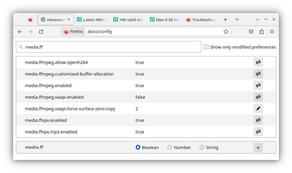

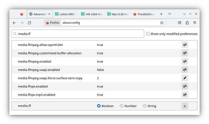

did you found media.ffmpeg.vaapi(v4l2).enabled?
Will double check. Most likely not as I don’t think S922X support “vaapi”.
vaapi replaced by something v4l2 or v4l2m2m?
I doubt it will work, It might have to be compiled against ffmpeg with vpu support or ffmpeg with v4l2-m2m enabled, which I doubt ffmpeg6 have v4l2-m2m enabled by default.

but can not found ‘media.ffmpeg.v4l2(m2m).enabled’ option?

but, how to check does HW work or not?
thought, v4l2 codes merge into vaapi module, so can not found ‘media.ffmpeg.v4l2(m2m).enabled’.
so, just flag ‘true’ to ‘media.ffmpeg.vaapi.enabled’.
am i right?
