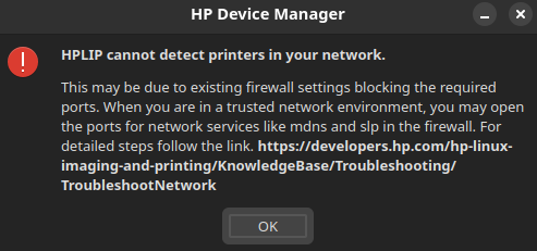

i’m trying to install hp m110w printer wirelessly. i get this message after scanning for printers. the wireless button was pressed during the attempts.
it is a gnome manjaro installation is is connected by an ethernet cable to a wireless router.

Hi @candlightandskull,
Make absolutely sure the printer’s wireless connection is functional. It needs the wireless security key (password) and so on.
I have no experience with HP and wireless, however this doesn’t look right.
First: does the printer respond to ping? eg
$ ping [nameofprinter]
If that fails, the devicemanager probably fails for this reason, there is no connection or name is not correct.
Make sure to follow the HP instructions to add the printer to the network.
