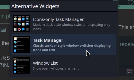

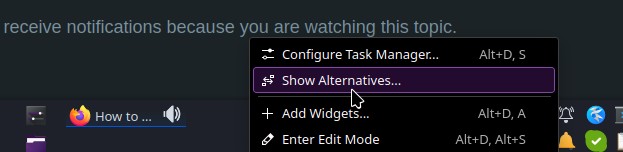

This should work by right-clicking the panel and selecting e.g. the classic taskbar-style:
Screenshot_%Y%M%D_%H%m%S-9
Screenshot_%Y%M%D_%H%m%S-10
…It’s worth noting that this didn’t work previously (with Plasma 5.27) for me. It does now, evidently.
