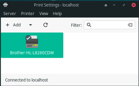

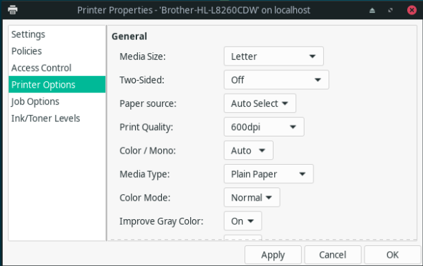

There is another place to configure the default CUPS printer settings
  • the universal cups admin application is always available http://localhost:631
Optional GUI packages depending on desktop (not default included)
  • For GTK based desktop: system-config-printer package
  • For Plasma desktop : print-manager package
For Xfce one would choose a GTK
pacman -Syu system-config-printer
From the Xfce control panel you can launch the Print Settings application and set the printer defaults to use Letter papersize
Sample screenshot
