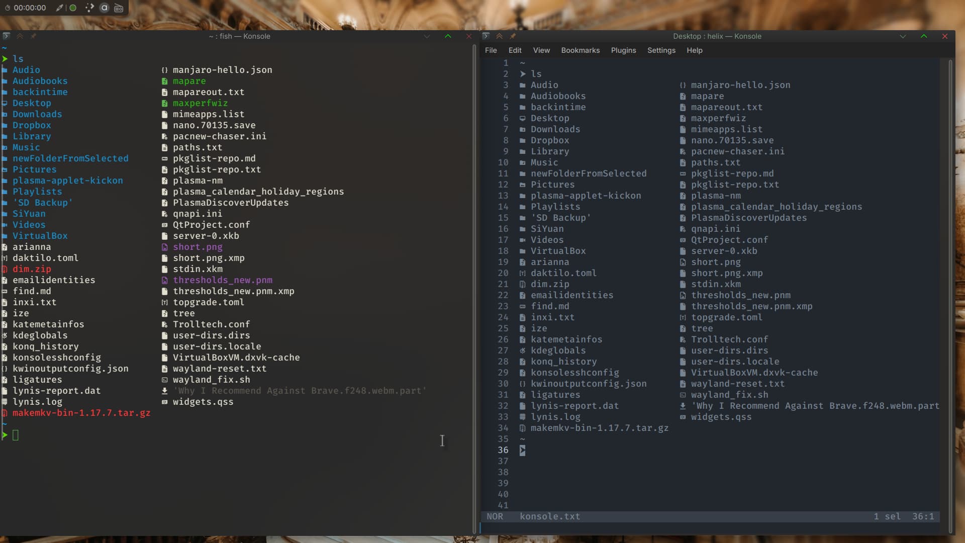

Konsole… Try this:
ls
Now save with CtrlShiftS - I just saved to ~/Desktop/konsole.txt and opened it with helix.
