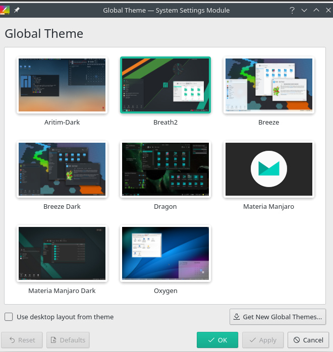

Thank you for the reply! That’s odd. Here you can see I have Breath2 installed and applied:
Brave is downloading the manjaro-gnome.iso:
Then I switch back to global themes menu and no progress bar on Brave icon:
So definitely not working for me
I’ll try copying the .iso when it downloads to see if the progress bar works on the Dolphin icon, but I know it has always worked on Brave and Pamac in other distros running plasma/
