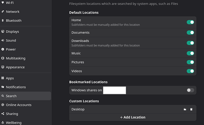

Hey, thank you for chiming in. My system settings look a lot different to yours however. Under Search there is only in what order I want to see search results and when I click on Search Locations, there is the following:
That looks like Gnome, and with that
:man_shrugging:
(And that would, I think, explain why there’s no baloo config files.)

Default Locations → “HOME”
Subfolders must be manually added …
Same for “Downloads” (which is whithin /home, so that is ambiguous, not clearly explained …)
