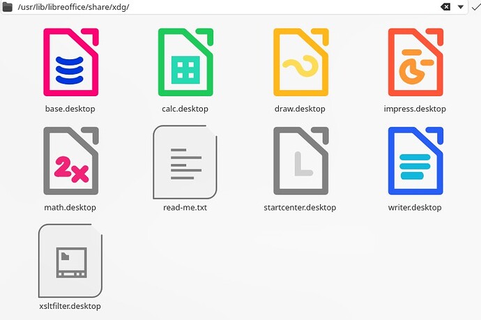

Unfortunately, it only works when launched from terminal. If I modify launchers from start menu, it doesn’t work, because LO doesn’t hold launchers (.desktop files) in user space. I even decided to modify the original launchers on the root folder (aware that they will be overwritten on each LO update), but it never works.
To give you details: I modified launches in:
/usr/lib/libreoffice/share/xdg/
so they would have in exec line:
Exec=QT_STYLE_OVERRIDE=Breeze libreoffice %U
and so on. When I click on those files and launch them, it launches correctly with the breeze override. When I search in the start menu and check the launcher command it also shows correctly with breeze override but… when launched from start menu, the theming is not overwritten. The same when I pin the shortcut to the panel/desktop - it also launches without override.
Any idea how to set it up permanently and on which file? Semi-permanent (until next LO update) will also do.

Thank you @FadeMind ! This is the solution!
For the sake of others, I simplify it here:
Instead of libreoffice, I had to use /usr/lib64/libreoffice/program/soffice.bin
So what I did, I edited those lines (line numbers in brackets):
/usr/lib/libreoffice/share/xdg/calc.dekstop
[18] Exec=QT_STYLE_OVERRIDE=Breeze /usr/lib64/libreoffice/program/soffice.bin --calc %U
[43] Exec=QT_STYLE_OVERRIDE=Breeze /usr/lib64/libreoffice/program/soffice.bin --calc %U
/usr/lib/libreoffice/share/xdg/starter.desktop
[25] Exec=QT_STYLE_OVERRIDE=Breeze /usr/lib64/libreoffice/program/soffice.bin %U
[46] Exec=QT_STYLE_OVERRIDE=Breeze /usr/lib64/libreoffice/program/soffice.bin --calc %U
