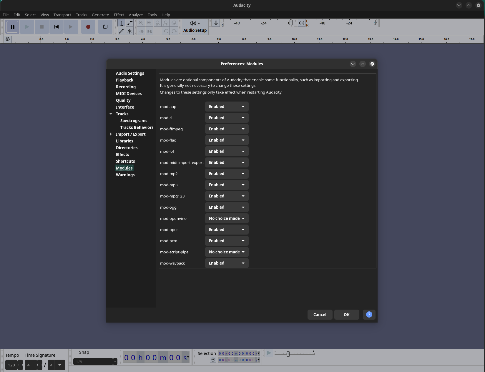

mod-openvino module is in the module’s list in audacity!!
OMG!!
I’m not done yet, but this is a HUGE win.
My brain is mush.

edit:
I may have spoke to soon, when I enabled mod-openvino in the drop down, closed audacity and opened it, I got a dialog:
"Unable to load the ā€œmod-openvinoā€ module.
Error: Inappropriate ioctl for device"
So still have got a way to go it seems.
The fact that the package built and the module is listed is still a huge win.

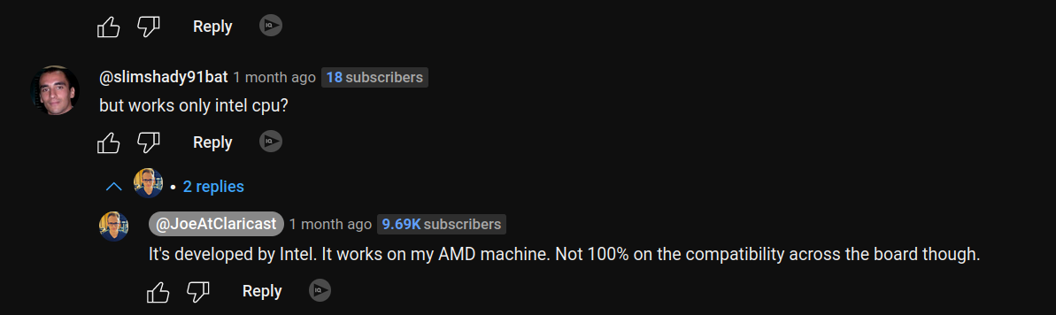

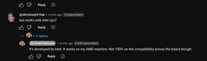

Although I have amd/nvidia prime graphics cards, and this comment suggests openvion only supports intel after all: [CLDNN ERROR]. No GPU device was found. Ā· Issue #452 Ā· openvinotoolkit/openvino Ā· GitHub
Yet that comment is also 2 years old, yet there is anecdotal evidence, see my screen shot of a youtube comment on a video about the plugin that it does work with nvidia.
So I even if I continued it still may be a fool’s errand.
