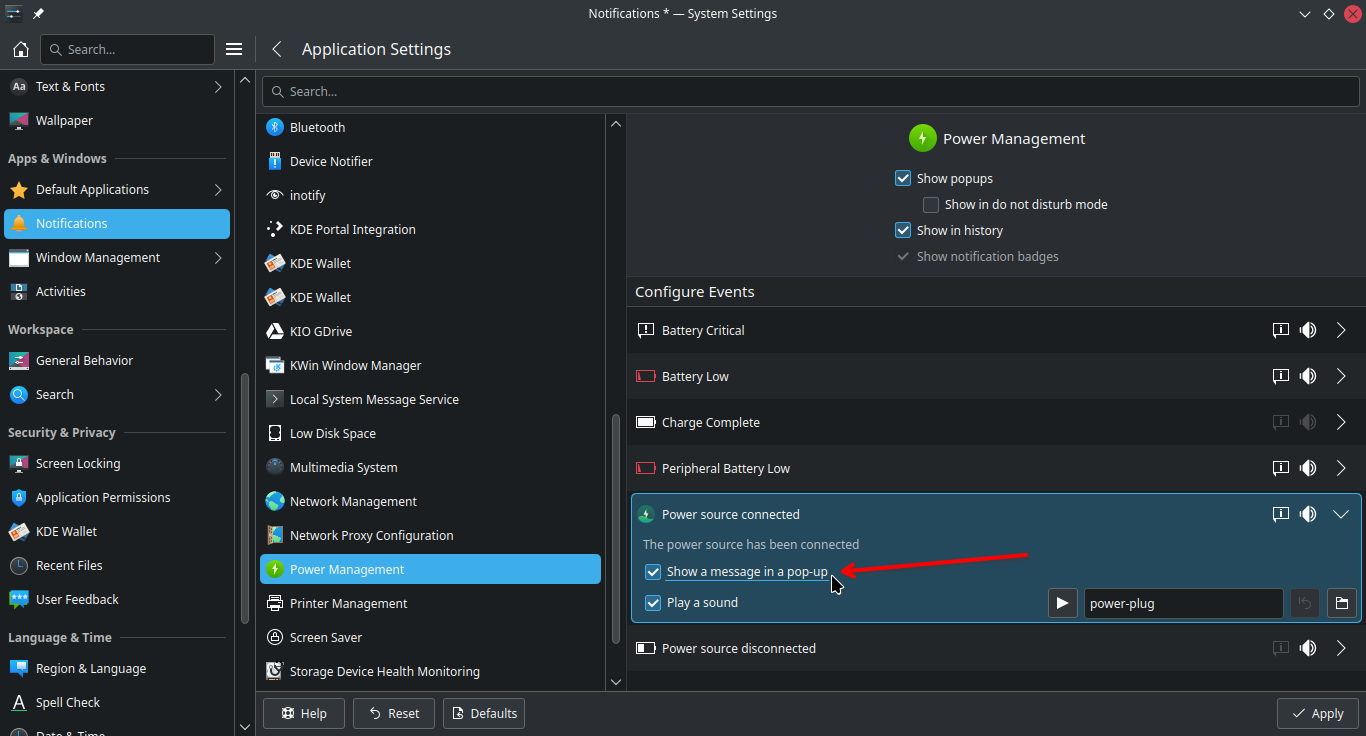

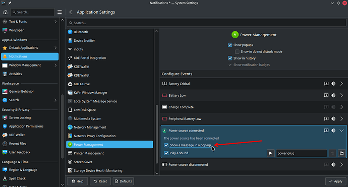

There are already notifications for these events, their sounds are already enabled, you just need to enable their visual popups:
well, I’m currently using that, but that shows a regular notification.

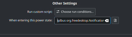

I don’t know if this will work on your laptop, but:
Then add the following command to “When entering this power state”
qdbus org.freedesktop.Notifications /org/kde/osdService org.kde.osdService.showText battery "AC Connected"
Screenshot_20240524_123531
Screenshot_20240524_123601

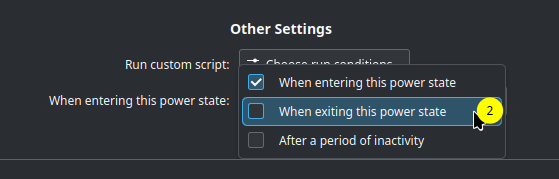

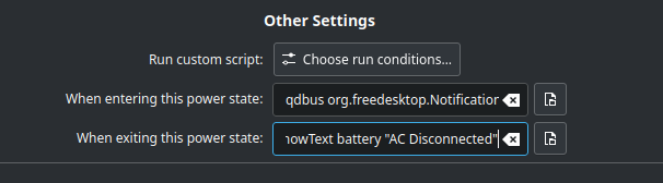

Then add the following command to “When exiting this power state”
qdbus org.freedesktop.Notifications /org/kde/osdService org.kde.osdService.showText battery "AC Disconnected"
Screenshot_20240524_123726

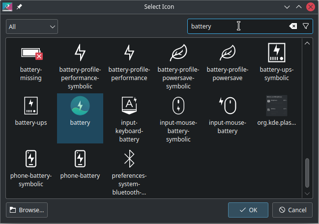

NB: You can change that “battery” icon to another one by picking name from icon selector
Screenshot_20240524_124204
