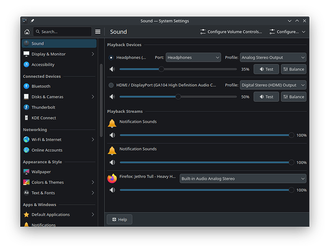

i have headphones connected to the front of the computer case and S/PDIF on the back,going to speakers.
in order to hear from the headphones i need to choose “analog stereo output” in KDE’s sound system setings.
and in order to listen to the speakers i need to chose "Digital stereo (IEC958) output.
the thing is that i need to got to the system settings each time,and have no quick way to swap between them in the task bar under the volume icon.
(i do have between the screen speakers(HDMI) and headphones or headphones and the speakers when connected via Bluetooth.
i hope it’s clear.
i found a similar question/answer but don’t know how to apply it to my case.

You should be able to set the device’s output profile in the audio popup by clicking the three-stripe burger menu beside the volume level slider (a popup with all available profiles shows up).

alright,sorry to have bothered you,but as said by @renkforce; there’s a burger menu next to the volume slider that i missed, and you’re able to change the output from there.
