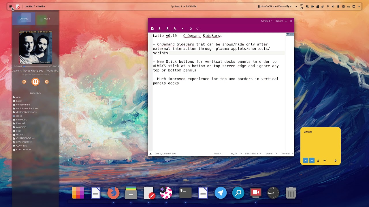

I have Latte Dock 0.10.8-1 + latte integrale 1.7.6-2 + Plasma5-applets-latte-sidebar-button-git 0.2.1.r0.g611b0 installed. It works finally and it is possible to integrate app out of KDE Store.
But how can I open and see the sidebars that appear briefly when starting Latte Dock? See example image.
I can’t access this side bar, why?

Hello Susanne,
Are you using wayland or X11?
If you use Wayland I could imagine fewer problems.
Please use X11
Regards
josephine

I use X11
Where can I find and download this shortcut set? In the Software Center I cannot find this set.
Well, you already have installed the required one
Now you have to add it to the Panel or the Latte Dock, as widget and then in settings set it to show on all edges, or see what other options are available there.
https://camo.githubusercontent.com/628dd42dfed0a80a35e6e5630d400d35cfb23873b0c8f97859fc85318183c3f5/68747470733a2f2f692e696d6775722e636f6d2f6a4d73316d516d2e706e67
https://camo.githubusercontent.com/8dfa99b30cce221c33c2f9178887492cded2ad77942c987c7174df68107f98df/68747470733a2f2f692e696d6775722e636f6d2f526230357571622e706e67
Oh my good, it works :heart_eyes: thank you very much.
