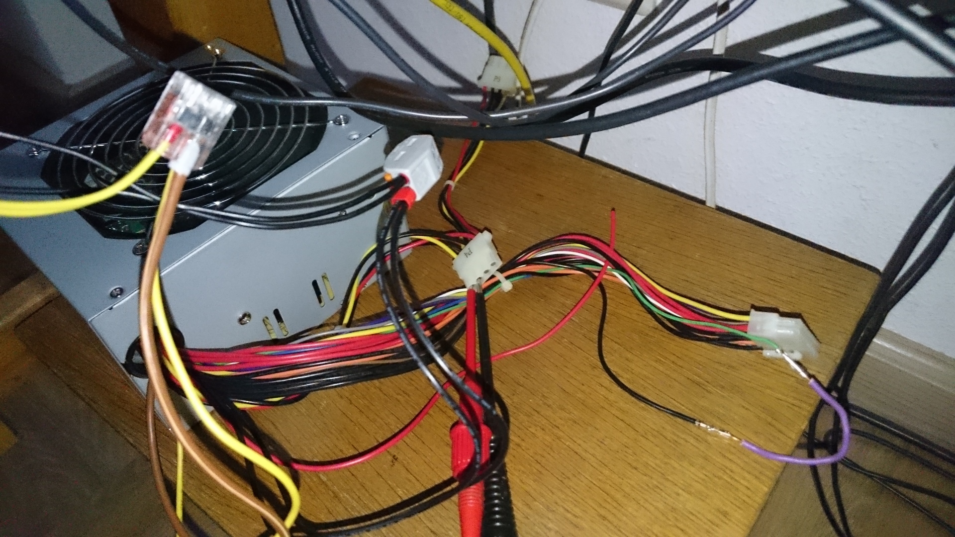

I once had the issue that my power supply (PSU) wasn’t enough for my GPU. So I added another one to test things (bc my screen would just turn black) and then as a temporary measure, until I got a new more powerful one.
If you have second PSU, you could try this as well to see if it fixes things. However I still think it is coil whine. Check this video:
With this method you can try to locate it.
