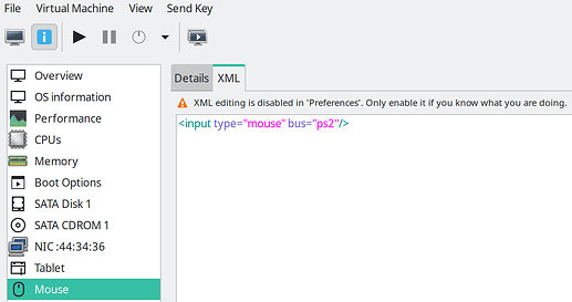

I’m attempting to modify the XML section in the mouse tab
I run virt-manager as root but no matter how many times I enable XML editing that doesn’t unlock the actual editing. This issue have been reported elsewhere already, it seems a root issue.
If I run virt-manager as non-root the .xml field is accessible (is possible to type in) but as soon as I hit the Apply button I get Error changing VM configuration: xmlParseDoc() failed
I then tried modifying the XML via terminal. I used mostly nano, virsh gave me an headache ![]()

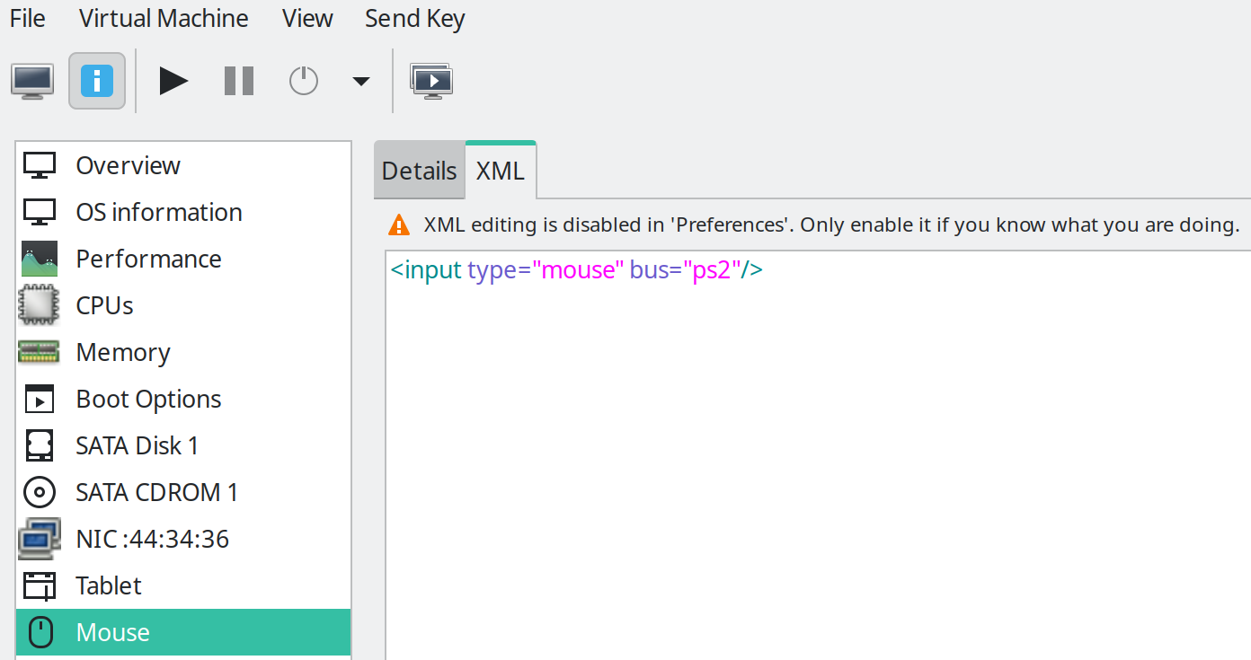

As shown in the screenshot the mouse XML by default is <input type="mouse" bus="ps2"/>. I started making minor changes like <input type="mouse" bus="ps2"></input> just to see if back in the GUI I could see a change in the XML. I obviously sudo systemctl restart libvirtd every time i did the change.
…Nothing. No change in the XML.
