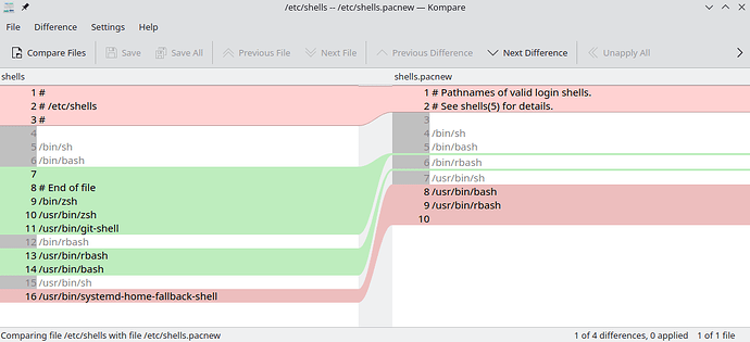

I need help with my two last pacnew files. Managed to deside about 23 others, but these two are to hard for me, even after searching for similar posts.
I never installed or removed shells, started with Manjaro KDE in 2018, so I dont know what to do with these two files, merge or delete the pacnew or replace the shells file with the pacnew version:

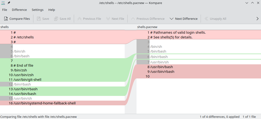

I used screenshots of Kompare, hope that is OK.

As for /etc/shells:
the .pacnew doesn’t have anything new in it - the shells in line 8 and 9 are already in the file on the left
so:
there is nothing to do
I have no idea about the second one since I don’t use that software.
Logically though, if you have not altered the original yourself, it was the default that got installed some time ago -
and now there is a new default.
Therefore I’d replace the original with the .pacnew
You can always create backups of the files so that you can go back, should you need to.
O,o, you are right… didn’t look careful enough. I wil delete the pacnew.

Whilst @Nachlese is correct, I would take the opportunity to tidy up the file and bring it in line with the pacnew. The order doesn’t matter, I just stuck with the pattern I saw in the pacnew.
# Pathnames of valid login shells.
# See shells(5) for details.
/bin/sh
/bin/zsh
/bin/bash
/bin/rbash
/usr/bin/sh
/usr/bin/zsh
/usr/bin/bash
/usr/bin/rbash
/usr/bin/git-shell
/usr/bin/systemd-home-fallback-shell

I think you only need that one if you use systemd-homed, which is not configured in either Arch proper or Manjaro. It doesn’t even have a man page, and I just tried it with the --help option to see whether it could offer some information, but it threw an error message.
I thought as much myself, I only included it because it was in the original.
I’ve seen a couple of people have tried using systemd-homed, though I can’t remember the details, the OP may have also.
:man_shrugging:
systemd-homed is a solution to a problem that doesn’t really exist. :wink:
That sounds reasonable, I replaced the file.
