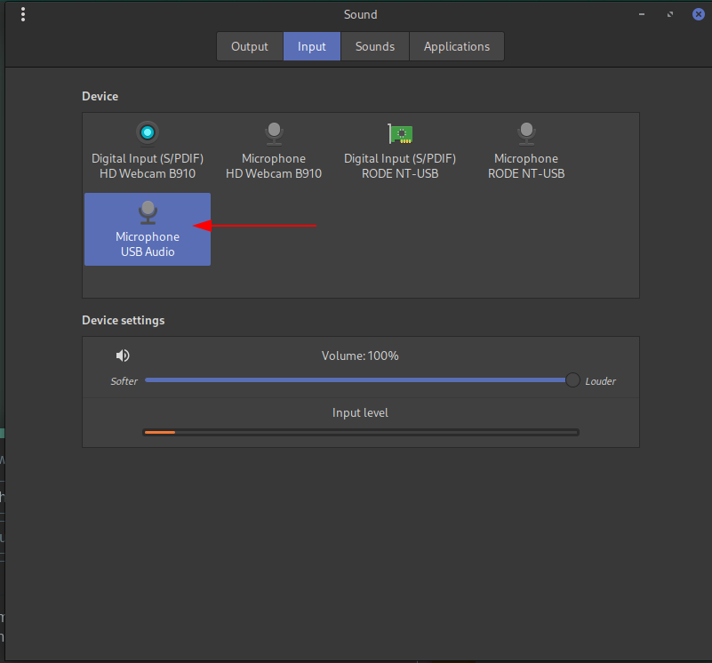

Hi,
my headphone microphones stopped working, both USB and jack.
Other microphones, e.g. webcam or microphones standing on my table still work though.
(I think the difference might be in devices with more than one audio line?)
The headset I plug in via jack (not USB!) is shown below, the input bar cannot be moved by any means.
Note that before of this, I had been messing around with pulseaudio, alse, jackctl and whatever wire stuff to get a Focusrite sound interface working. Sound output and input had been working fine after (but I surely did not know what I was doing)
After a Manjaro update, I experienced this on both headsets, both with a different type of behavior, but in essence:
I also had annoying sound disturbances like if a very sensitive sound cable is hit, popping noises.
I was able to fix this behavior by following the advice:
After this, sound output was working like a charm. But then I discovered, that my input had stopped working entirely (might have been gone for a while, not entirely sure that this is the point, but I believe so).
I was not able to find any solutions via search engine or GPT.
I also tried switching the desktop environment, but neither in XFCE, KDE Plasma or Cinnamon does the sound input work. KDE Plasma was worst, here, even sound output did not work.
During debugging I found that the pulse user was missing, and that I was not in the audio group, which I created and added, and fixed some errors in journalctl.

I am clueluess how to continue forward now to get these microphones working again. Ideas?

pactl data shows ALSA cards 0 and 1 are for HDMI audio outputs from nVidia GPU and onboard AMD. Both are inactive
$ pactl list cards
Card #51
                device.product.name = "GP106 High Definition Audio Controller"
                device.vendor.name = "NVIDIA Corporation"
                alsa.card = "0"
                alsa.id = "NVidia"
        Active Profile: off
Card #54
                device.product.name = "Radeon High Definition Audio Controller [Rembrandt/Strix]"
                device.vendor.name = "Advanced Micro Devices, Inc. [AMD/ATI]"
                alsa.card = "1"
                alsa.id = "Generic_1"
        Active Profile: off
ALSA card 3 is the USB webcam microphone
Card #55
                device.product.name = "HD Webcam B910"
                device.vendor.name = "Logitech, Inc."
                alsa.card = "3"
                alsa.id = "U0x46d0x823"
        Profiles:
                input:iec958-stereo: Digital Stereo (IEC958) Input (sinks: 0, sources: 1, priority: 55, available: yes)
        Active Profile: input:iec958-stereo
ALSA card 4 is the onboard audio device (Realtek ALC4080) that the Beyerdynamic headset is probably connected to using front panel 3.5mm jacks
The Realtek ALC4080 on the new Intel boards demystified and the differences to the ALC1220 | Insider | igor´sLAB
The ALC4080 is a single-chip, multi-channel USB audio codec that embeds a USB 2.0 controller with a high-performance audio codec. For USB audio, it supports a standard HID-class USB audio device designed for PC motherboards and multi-channel audio systems/devices in all major commercial operating systems, such as Windows, Linux, iOS, macOS, and Android. It offers ten DAC channels supporting simultaneous 7.1-channel playback, as well as two channels of independent stereo output (multiple streaming) via the front-panel stereo output
A total of three stereo ADCs are integrated and can support multiple analog audio inputs
Card #53
               device.product.name = "USB Audio"
               device.vendor.name = "Micro Star International"
               alsa.card = "4"
               alsa.id = "Audio"
       Profiles:
                 HiFi 7+1: HiFi 7.1 channels (sinks: 3, sources: 2, priority: 1000, available: yes)
       Active Profile: HiFi 7+1
       Ports:
               [Out] Headphones: Front Headphones (type: Headphones, priority: 300, latency offset: 0 usec, availability group: Headphone - Output, available)
               [In] Mic1: Microphone (type: Mic, priority: 300, latency offset: 0 usec, availability group: Mic - Input, available)
pactl info in original post shows that Headphones is the default sink for audio playback and *Mic1" is default source for audio capture
Default Sink: alsa_output.usb-Generic_USB_Audio-00.HiFi_7_1__Headphones__sink
Default Source: alsa_input.usb-Generic_USB_Audio-00.HiFi_7_1__Mic1__source
If the Headphone output or Mic input are not working in PipeWire, check ALSA settings:
alsamixer --card=Audio --view=All
Or use this to get information in text format to post it online
amixer --card=Audio
Card 5 is the Rode USB microphone
Card #115
                device.product.name = "RODE NT-USB"
                device.vendor.name = "RODE Microphones"
                alsa.card = "5"
                alsa.id = "NTUSB"
        Profiles:
                off: Off (sinks: 0, sources: 0, priority: 0, available: yes)
                output:analog-stereo+input:analog-stereo: Analog Stereo Duplex (sinks: 1, sources: 1, priority: 6565, available: yes)
        Active Profile: output:analog-stereo+input:analog-stereo
A minor problem that might occur when using multiple USB devices is that the ALSA card numbers can change when system is rebooted, but the alsa.id name does not change, This is not usually a problem for PipeWire except that audio devices might be listed in a different order. If it is a problem or annoyance, cards can be locked to a specific number - Multiple USB Sound Cards - LinuxMusicians
For better control of multiple audio devices I recommend installing PulseAudio Volume Control pavucontrol GUI.
Input and Output tabs have a tick box to show default source and sink
Recording and Playback tabs have dropdown lists to record from or playback to non-default sources and sinks
Configuration tab allows user to change card Profiles (turn off unused cards or select the pro-audio profile for pipewire-jack)

Here is the output to the commands and tools you mentioned:
! image|690x358 ← not working
Imgur a/7DhoLQQ ← links also not working? Anyway, path is there :open_mouth:
$ amixer --card=Audio
Simple mixer control 'PCM',0
  Capabilities: pvolume pswitch pswitch-joined

I already tried pavucontrol to fix this.
! image|481x500 ← though even if media is disabled, clicking works when using space between ! and [ XD
As can be seen in the screenshot, both webcam and table mic (RODE) respond to my keystrokes (or hitting them). My headphone (I still do not understand why it shows as USB since it isn’t USB, but it might as well be an unimportant development relict) does not move at no point. Trying to capture sound using arecord does not catch a single tone.
! image|483x500
I am still clueless how to progress and how to further narrow the issue down.
