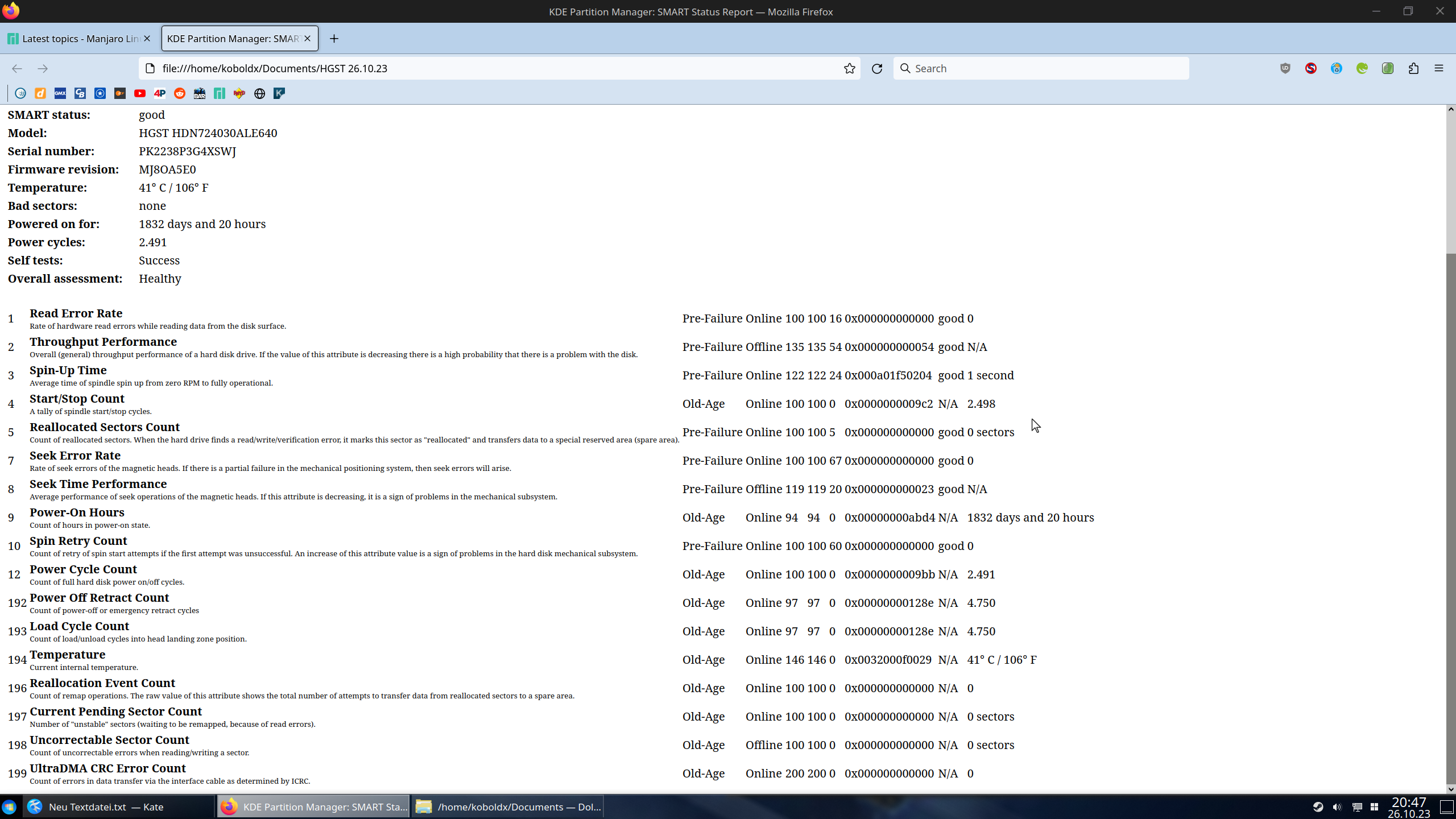

HDD with unsuccessful shutdowns, probably a smart status error?
My HDD is around 8-9years old and the smart values shows alot (4750) “Power Off Retract Count” but they are equal with “Load Cycle Count”. Strange huh?
Should i worry about my HDD? Or is this maybe just a false positive sensor error?
Im always normaly shutdown my PC with the Shutdown Taskbar GUI from KDE…
So im doing 99% of the time, just wait till my PC do his job… besides some hardware crashes and instabilitys in the past, where i had to press the reset or power button… but this problems are long time solved.
Today even in sleepmode the Power Off Retract Count still raising the value.
I also try’d this shutdown HDD Parking Script that someone recommend in a similar Topic,
but it doesn’t help me: https://wiki.odroid.com/odroid-xu4/troubleshooting/shutdown_script

In the current testing announcement there is info for a kernel bug (probably ported to all kernels, so stable is probably affected) affecting HDDs unable to shut down properly. So it is probably this.
Yes, it’s this;
@Teo
@MrLavender
I have Kernel 6.1.55-1 and 4750 Power Off Retract counts…
Do you guys really thinking, that i have shutdown my PC over 4000 times in this month?
My HDD is from 2014-2015… im also use Linux Manjaro since 08/2020 btw.
No, but our new problem is now masking your old one and it will be harder to debug.
Ok, yeah sorry I just jumped to conclusions with the recent discussion about that issue.
Looking at my TOSHIBA DT01ACA200, which is about the same age as your hdd, I also have 192 Power-Off_Retract_Count and 193 Load Cycle Count with the same value. I think this is normal. The label in KDE Partition Manager does say “Count of power-off OR emergency retract cycles”.
According to https://kb.acronis.com/content/9127
This parameter is considered informational by the most hardware vendors. The value is counted every time the heads are loaded off the media (i.e. every time the machine is powered down, put to sleep or is idle).
but Fujitsu in particular were using it for Emergency Retract Cycle Count.
So nothing to worry about in my opinion. The people reporting the recent issue have actually been able to hear their hdd doing an emergency retract instead of powering down correctly.
Not really - if the value was higher than load - I would consider it problematic.
Usually a power on is followed by a power off - so the values being identical shouldn’t be an issue.
