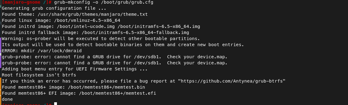

I suddenly ran into an issue with grub, it started showing black grub config screen. I followed the GRUB/Restore the GRUB Bootloader - Manjaro tutorial. When I get to the grub-mkconfig it returns the following error
I had something very similliar to this when I tried running os-probe. I have a dual boot Linux/Windows. My lsblk looks as follows:

It doesn’t fail on live usb - it throws an error in chroot, which is not the live system, but your actual system.
I say: ignore the errors - not important or fatal.
What is /dev/sdb1 and /dev/sdb2 which the errors are about?
Likely not needed at all during this operation.

I’d hazard a guess that the presence of the EOL kernel is what is causing the issue.
The OS will normally notify you when a kernel goes out of date and remind you to upgrade.
I updated the system and ran sudo update-grub. Even though the live usb helped with the black screen of grub, I couldn’t get the grub to show Windows as a bootable option, but update-grub nailed it down. Thanks to everybody, the issue seems to be resolved so I’m closing the thread
