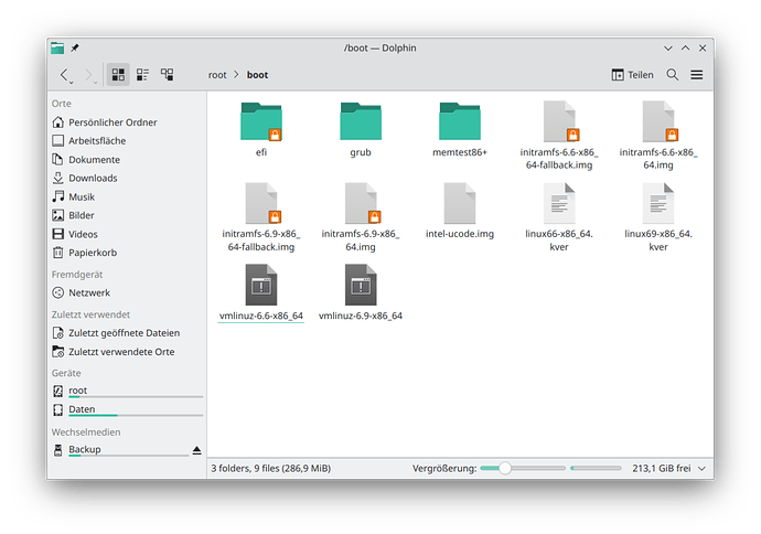

Thanks ben, but there is no vmlinuz-linux in /boot/, only the two files with the names of my installed kernels:
vmlinuz-6.6-x86-64
and
vmlinuz-6.9-x86-64
I have read the passage in the Arch Wiki, but now I don’t know how to change the row fole. What good is a path with the name of the kernel if it changes again later when I upgrade?
sorry if I’m being stupid :face_with_diagonal_mouth:
No, I said to replace vmlinuz-linux with the name off your installed kernel, so set the line in /etc/default/grub as:
GRUB_TOP_LEVEL="/boot/vmlinuz-6.6-x86-64"
