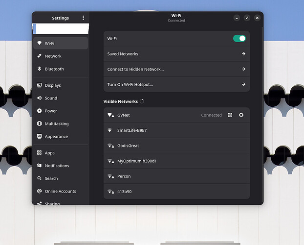

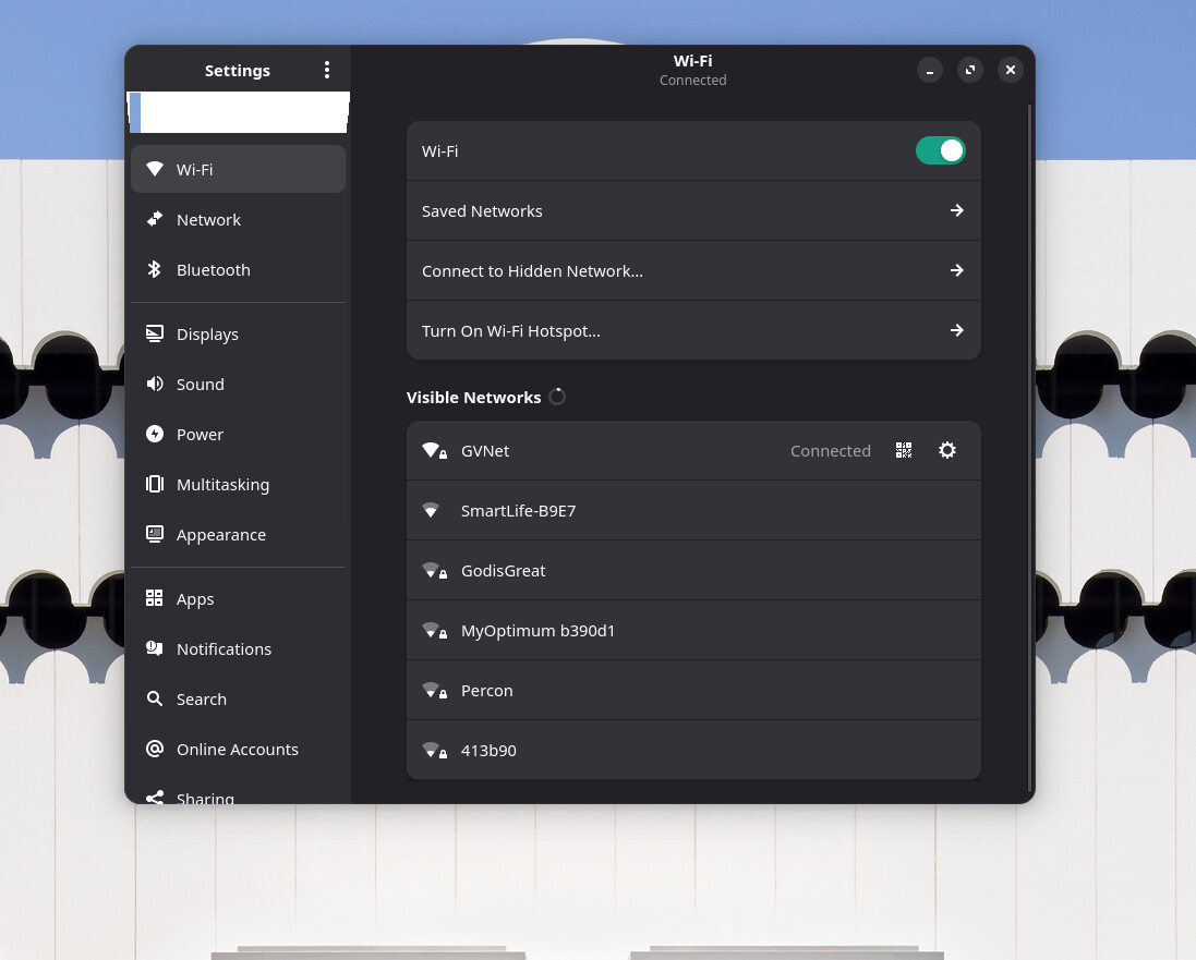

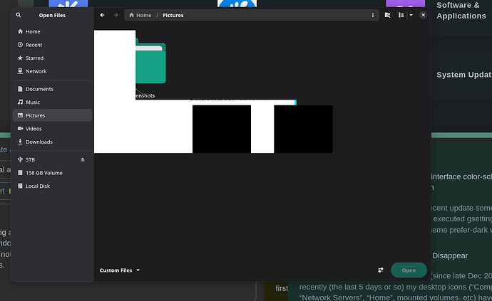

Graphical artifacts on Gnome interfaces (Intel B580)
I’m seeing a lot of multi colored artifacting and other odd issues like desktop icons randomly disappearing. It only seems to affect the GNOME interface itself, apps do not have the issue and videos display fine across multiple different browsers. The issue started soon after a graphics driver update and I’ve read that Intel ARC cards don’t always like to play nice on Linux, so I suspect that’s the issue, but I have no idea how to confirm that theory
Please let me know if there’s any additional info I can provide for better troubleshooting!
Examples of the issue:

I spun up a new user account and the issue still occurred.

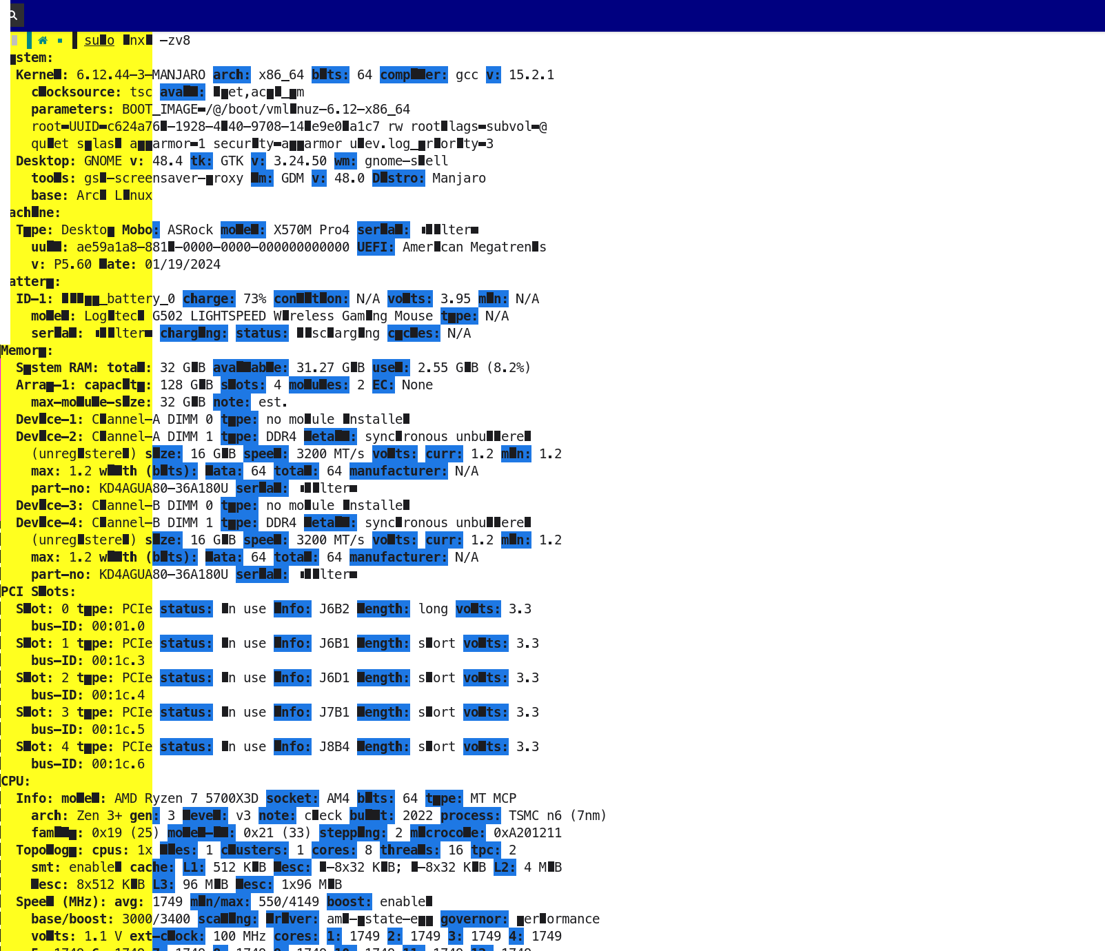

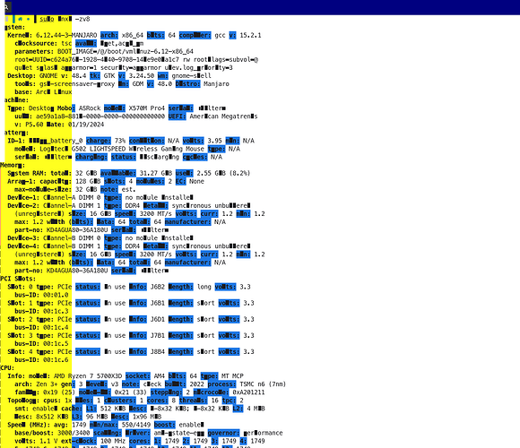

Here’s the output from the inxi -zv8 command:

Vivaldi (my most used app at the moment) works perfectly fine when it doesn’t have to interact with my local files, but will start to hang and eventually freeze when I (for example) try to upload something. This was an issue earlier today when I tried to upload this screenshot of the terminal:

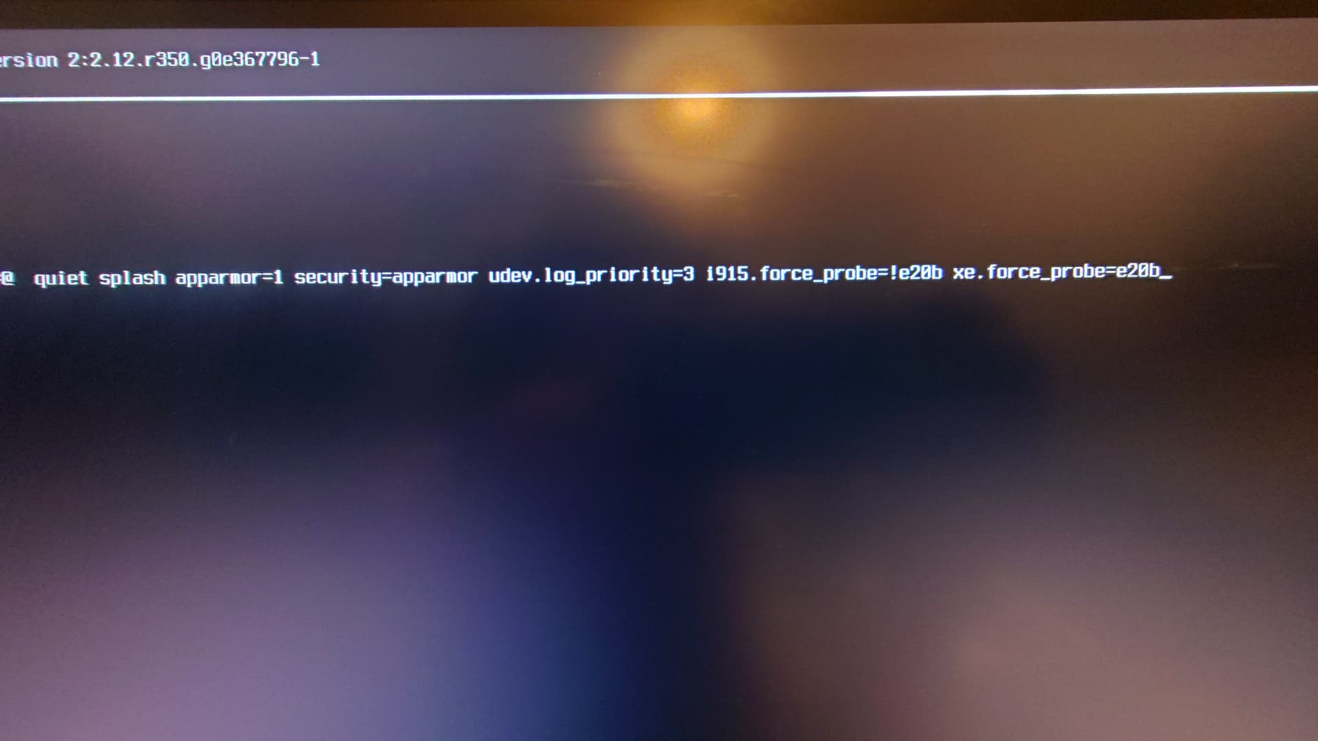

I’m far from an expert on graphics, but I am wondering if you might need to follow some extra steps to get your ARC B580 card working with the xe driver:
5.5 Testing the new experimental Xe driver - Intel graphics - ArchWiki
To try the (experimental) new Xe driver, you need:
  • linux 6.8 or above
  • Tiger Lake integrated graphics and newer, or a discrete graphics card.
  • mesa.
Note your PCI ID with:
$ lspci -nnd ::03xx
00:02.0 VGA compatible controller [0300]: Intel Corporation TigerLake-LP GT2 [Iris Xe Graphics] [8086:9a49] (rev 01)
Then add the following to your Kernel parameters with the appropriate PCI ID:
… i915.force_probe=!9a49 xe.force_probe=9a49
Make sure you have an alternate solution to boot in order to revert if necessary.
Edit: although I do also note that your inxi output does state that the xe driver is being used, so I’m not sure if the above advice is still relevant.
I gave that a shot, but it didn’t work. I’m also not sure I did it right: does that line need to be added to grub on the “linux” line like in the kernel parameters guide you linked to or is there somewhere else it needs to go?
You have it on the correct line, however you also have a typo in it. 1915.force_probe needs to be changed to i915.force_probe (i.e. change the first number 1 to the letter i).
Thanks for the confirmation, and the correction.
Picture of the corrected GRUB entry:
Unfortunately it still didn’t fix my issue after booting with ctrl+x.
To see if I could maybe fix the issue myself I uninstalled the two vulkan-intel driver packages on my system, the problem didn’t reoccur until after I reinstalled them.
This may be just a shot in the dark, but I do wonder if the issue may be caused by your system having 2 graphics cards: the AMD integrated GPU, and the Intel Arc.
Edit: you can probably ignore this - I just checked, and the Ryzen 7 5700X3D doesn’t have integrated graphics. The “3D” in the name had me assuming it did have an iGPU.
Though this topic might still be worth having a read through (I’ll link to the solution post):
It definitely sounds like the driver update is the main culprit here, especially since the glitches are limited to GNOME and not video playback. Intel ARC support on Linux is still a bit hit-or-miss depending on kernel and Mesa versions. You might want to check if you’re running the latest Mesa drivers and kernel, or even try rolling back to the previous graphics driver to see if the issue clears up. For instance, I only noticed smoother playback on Freecine: https://modilimitado.io/pt/freecine/ once I updated Mesa, so sharing your kernel version, distro, and current Mesa package versions would help others give more precise troubleshooting steps.
please check your bios-settings for “resizable-bar” aka rebar. it is mandatory that the mainboard supports it and it’s enabled to use the intel ARC-Bxxx models.

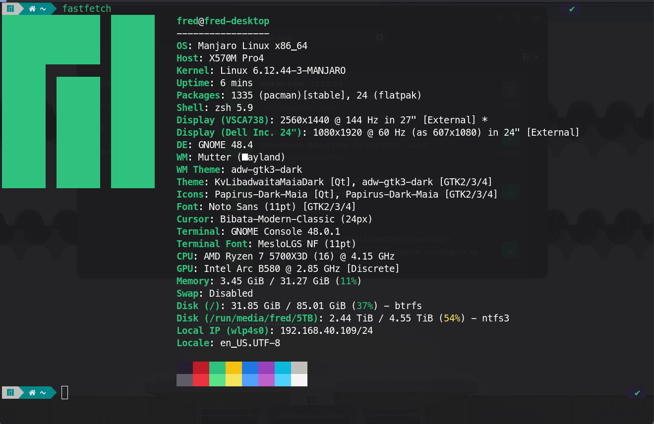

Distro is Manjaro GNOME, rebar is turned on. Mesa version is 1:25.2.1-4, Kernel is Linux 6.12.44-3-MANJARO. Will look into how to roll back drivers, thanks for the suggestion
